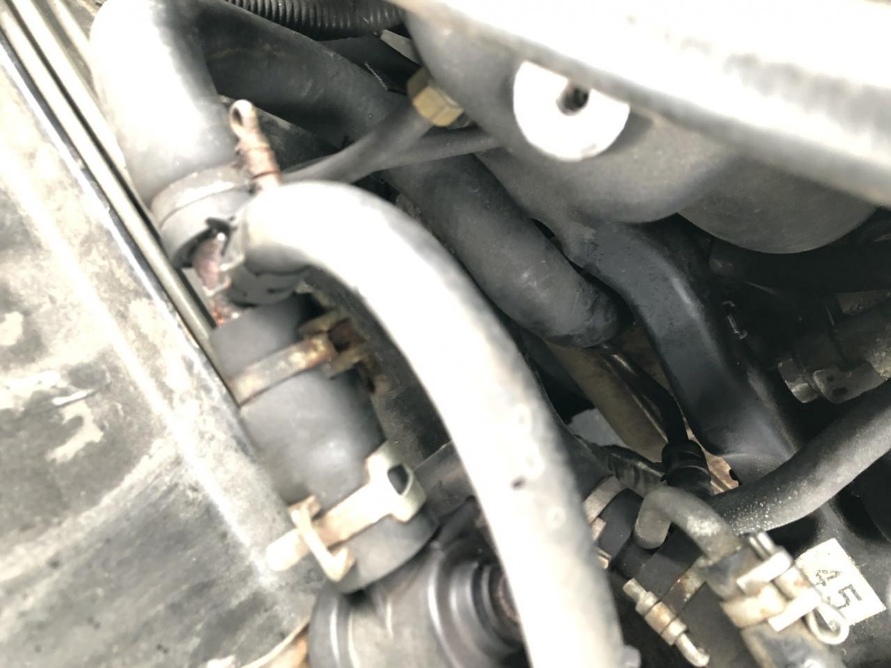

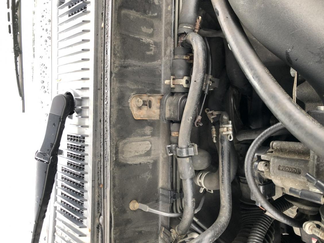

Ok so I called a dealership to get correct parts and was given also given part numbers for two hoses that come off of the valve. However when I look at my valve in my truck it doesn’t look like the parts diagram? Mine has two hoses that come off but on the right it splits and there is a “T” connection.
My truck is a 96 and has a rear heater. So I’m wondering if they changed the hoses after that year?

You need part# 87240-35050 (used through 98). They probably gave you 35070, which works from 99 through 02.
There is a thread here which tells the differences but it has to be five years or older. The OP ran into the same problem.
