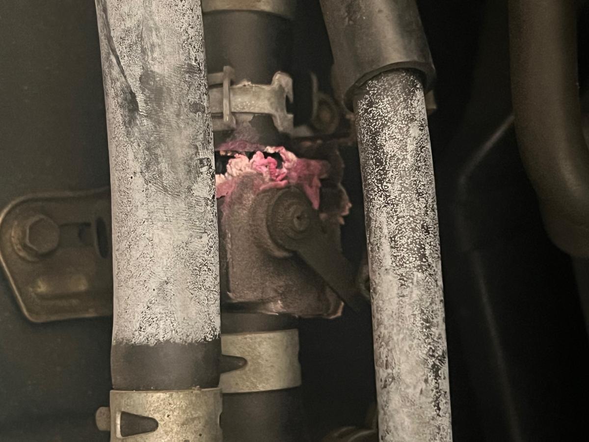

I got back home and found dried coolant (I told my parents to drive it) on what I believe is the heater valve?
I don't know if it's the valve or the hose clamp, but I'm going to replace the old valve before it gets worse. Should I go OEM for this part? To change it will I have to partially drain the coolant?

I'd go oem, as it has lasted that long already. It could also be the connecting hoses weaping. You can use hose clamps to clamp the hoses so coolant won't leak out, swap out the valve, when done take off the clamps and your in business. Burping the system is recommend after that though.
I've gone thru 4 OEM heater valves in 200k of owning my '01.
Its got an original (never opened) AC - original rear brake seals - original alot of things yet that part fails and fails - weird.
Its the highest point on the cooling system - just remove it and replace - no draining needed.

You're at the milage I'd change it.
I have not changed one, but have an oem on shelf and plan to do as preventative soon. I think I have read in other threads that there is another small plastic pipe near the valve that can be brittle and break as well when your doing the swap out of the valve
Yes, be very careful pulling hoses off - even with the correct tool.
My hoses survived, but a chunk off the valve stayed in the firewall hose.
happened to me >_<. the nipple on my valve broke off while driving and dumped my coolant.
So to replace dryer system has to be evacuated and recharged - correct?
Just unbolt the old one and pop in the new one then replace any coolant that may have dropped before or during the install, burp/bleed, and done.
