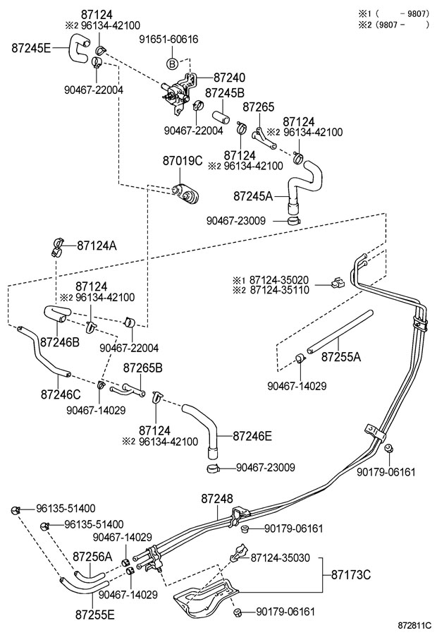

Check out oemtoyotapartsgroup.com for a schematic of our trucks and you can pull part numbers for each there, then take those numbers to a dealer or cross reference online for aftermarket. Your last option is to find good ones on a junkyard rig, but that's hit or miss.
i started looking into the part numbers and found out
there are 2 different part numbers for the same hoses
example like hose 87245b on the diagram
has two different part numbers
8724535630
and
8724535690
the difference is
"vzn and rzn"
anybody know the difference between the codes above?
