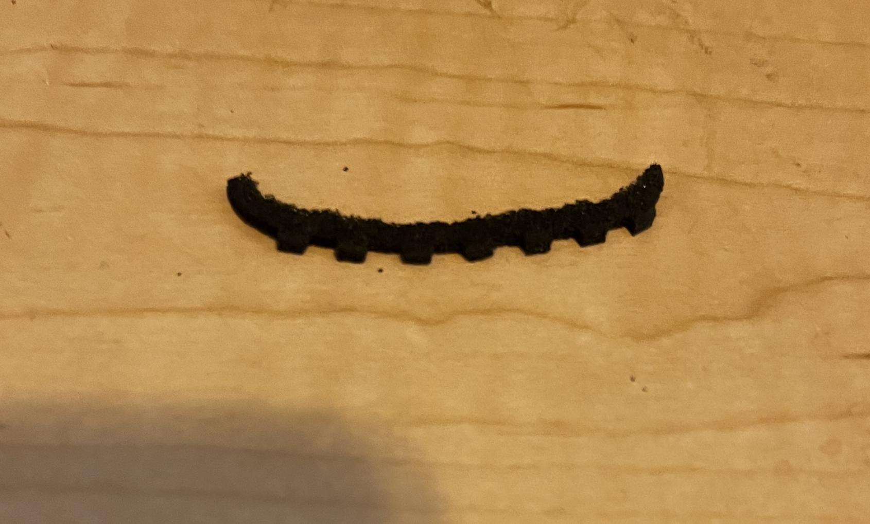

I just replaced the drivers side Air Mix Damper Servo in my Limited. In the Limited there are Left and Ride side Air Mix Damper Servos. The left side servo is easy to remove. The blend door can be worked manually which should direct heat to the drivers side. The right side servo is partially blocked by the blower motor housing. I think it is possible to see and feel the servo working with the HVAC control.
