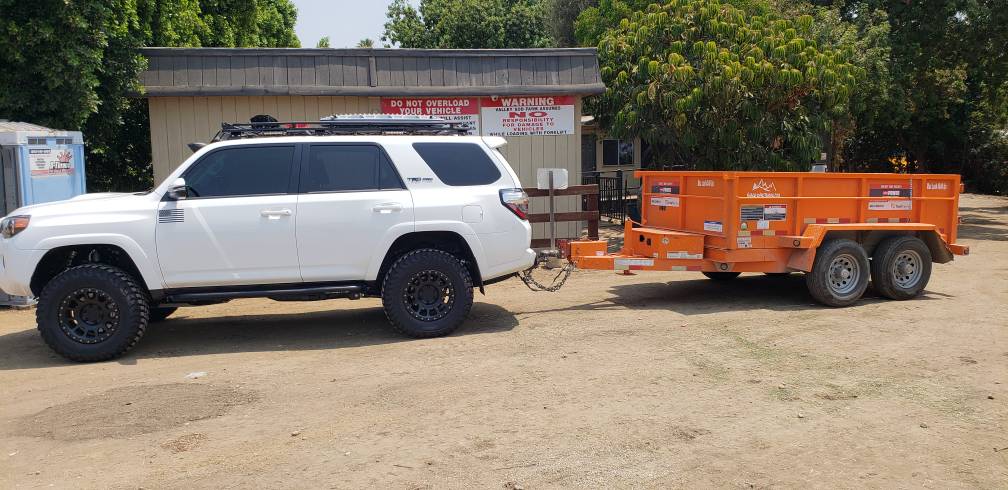

Total 5650lb.

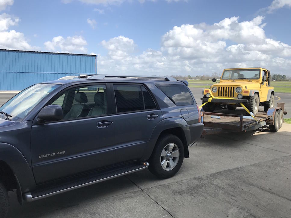

I towed a 98 Jeep with my 03 4Runner. It towed it pretty well, just don't go crazy with the brakes and give yourself time to slow down. It was mostly on flat land. The trailer was about 2000 pounds and the truck was a little over 3,000 so I was a little bit over. I was able to tow it down the interstate at 70.

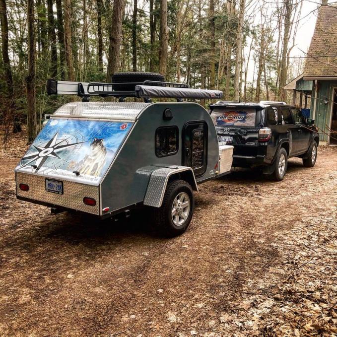

I'm thinking this little guy shouldn't be too bad to tow, likely around 1200 lbs. Using lock'n'roll hitch. Just have to get a 7-pin extension because Toyota puts the plug so far away from the hitch.

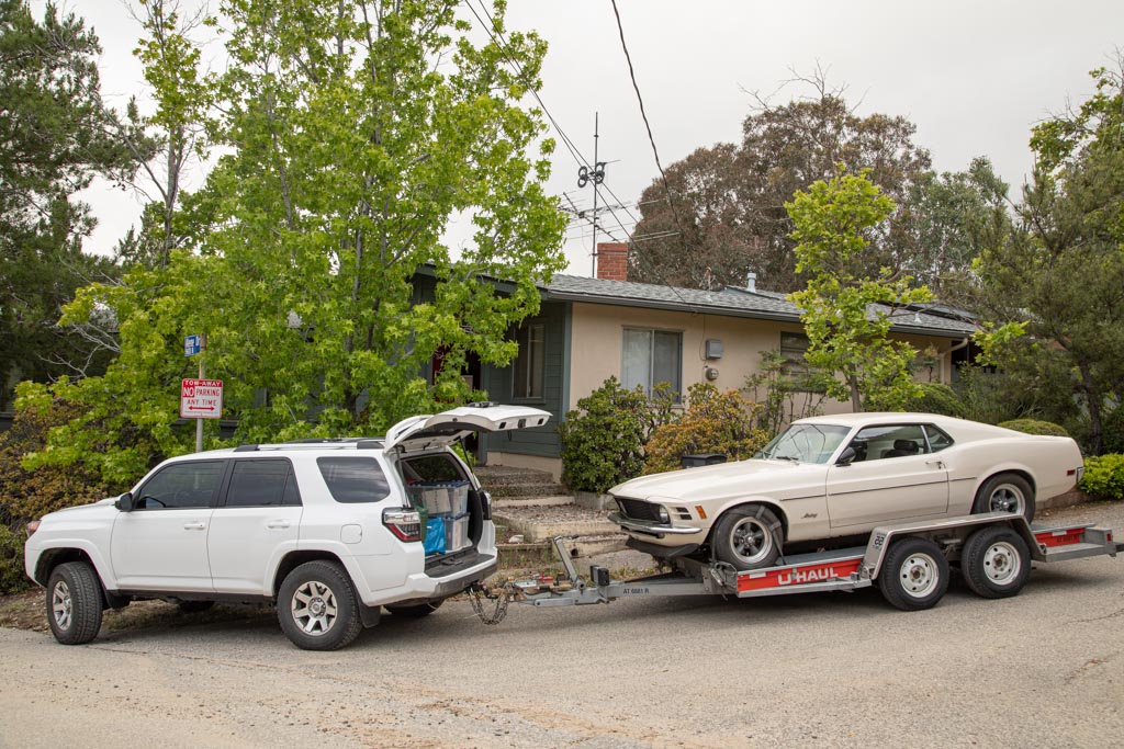

I just towed my 1970 Mustang from L.A. to Eugene, Oregon. 850 miles up I-5 with a couple of 4000'+ passes.
U-Haul trailer plus Mustang was around 5,600 lbs., or a bit over the official 5,000-lb. towing capacity.
Even with the rear suspension supplemented with Air Lift airbags at 30 PSI, the tongue weight was enough to put the nose in the air a bit.
Handling was completely stable and secure. I cruised easily at 60-65 mph in S4 and S5, controlling the throttle myself. Even on level ground with no headwind, I couldn't use cruise control at all -- it caused too much hunting in and out of torque converter lockup. I took the steepest uphill gradients near the passes at around 50 mph at 4,300 RPM in S2. S3 or S4 provided engine braking on downhill sections.
All in all, I came away impressed with the 4Runner's towing chops. I wouldn't want to tow that much weight with it every day, but for a one-time trip it was fine.
One thing to keep in mind is that the airbag levels out the ride or makes the ride better going over bumps. HOWEVER airbags DO NOT distribute weight equally to the front axle and the trailer's axle. Only weight distribution hitch does that job. Air bag will actually makes rear axle weigh more and lighter steering and handling.
