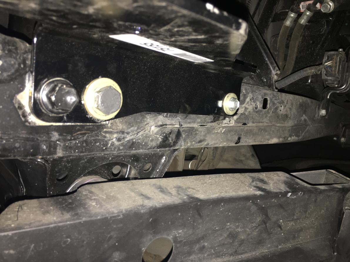

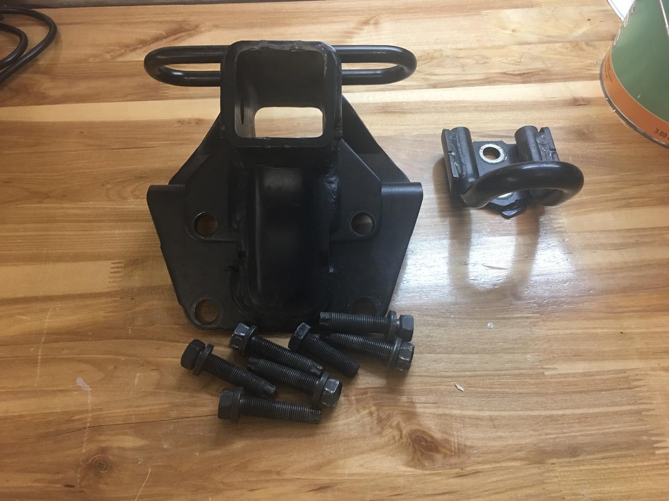

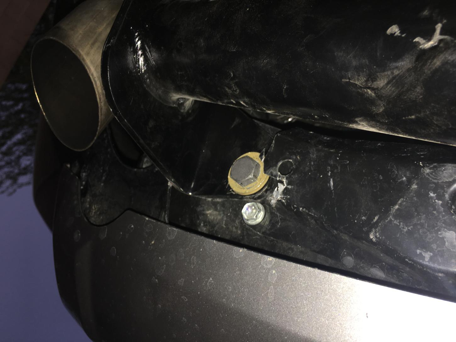

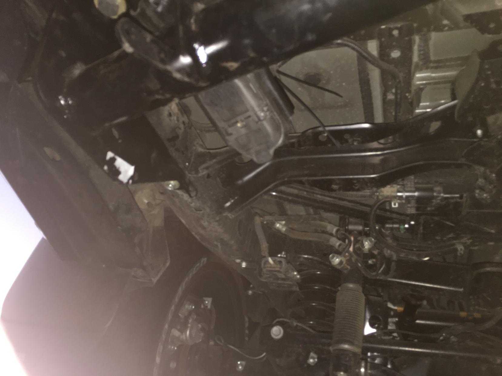

Okay, so after reading through all of this and taking all of this new information into consideration, I discovered that the frame on the 4th and 5th gen's are essentially the same. So much so that I was able to mount a 4th gen 7300lbs hitch to my 5th gen with zero modifications, it bolted right up in the factory locations. See the attached pictures. Removal of the rear bumper skin and spare tire is required to access everything. You will need to remove the factory tow hook in addition to the factory hitch to install the new one.
Drawtite 75155 - $155 shipped to my door, came with everything I needed to mount it.
https://www.amazon.com/gp/product/B001TNM00K/ref=oh_aui_detailpage_o00_s00?ie=UTF8&psc=1
I also plan on adding an additional trans cooler, brake controller, weight distributing hitch/receiver, and rear airbags to help the springs if I experience too much squat. We are moving to a new home this week (1/2 mile down the road) and I plan on renting a 8.5x20' trailer to test out how the 4runner handles it, 7000lbs GVWR. This would be residential streets only, speed limit of 45mph, and flat (no hills).

*This is at my own risk, I do not take any responsibility for anything someone might do with the information I am providing*
QUOTE]

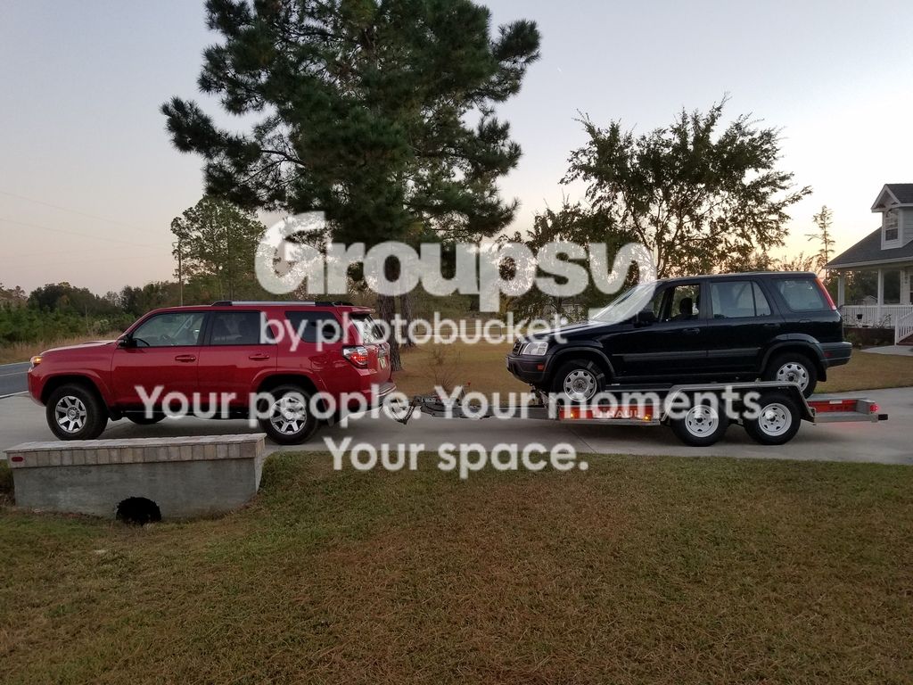

I really like this and have been curious as the stock hitch seems to be what is holding the 4runner to the 5k rating. The brakes are larger on the 4runner than the Tacoma, the driveline is essentially the same, but with more power. Front suspension is similar, rear is better (arguably), etc.
So, to contribute, i'll add my towing experience from this past weekend. We pulled out of the driveway with around 3500 miles on the 4runner. I've added a trans cooler as well as the airlift bags.
Per air lifts instructions, I measured the height at the back with the trailer unhooked. I filled the airbags to the max (35psi), then attached the trailer and pulled up the CRV. The rear raised about 1" when I filled the bags, then squatted about 1" when the trailer was loaded. I also increased the pressure in the rear tires (still running the stocks) from 32psi up to 40psi to help with the squat of the tires themselves. Loaded up the rest of the 4runner (gf, dog, luggage, etc) and headed out. The ride was firm, but nice and controlled. No wallowing, swaying, etc. If I had more time, I'd have messed with tire pressures and airbag pressures more instead of just leaving them at 35psi. I estimated the trailer weight at around 5500lb (2200 for the car hauler, 3200 for the crv, plus the crap in the CRV).
Impressions? The thing did fantastic. Power was never an issue, it's no speed demon of course, but it competently pulls. 90% of the run was in S4 mode in the trans, about 10% of the highway I was able to shift into S5 and let it go into overdrive then lock the torque converter in 5th. Brakes are fantastic. Not a worry or concern, confident stops. The trailer has surge brakes, drums on all 4 wheels which helped as well. Stability was very good, I believe had to be helped by the airlift setup.
Temps: I monitor temps through the torque app. Coolant never ventured above 190F, mostly maintained 186-188F. Trans pan temp mostly maintained 140-145F. Highest was 157F. No where near a concern, fantastic. Converter temp only reached around 180F max and quickly came down to pan temp when the converter locked. Attention was paid to make sure the torque converter stayed locked as much as possible to keep temps down. I was curious as it appears as though the torque converter does not lock in 3rd?
Fuel mileage: I averaged around 70-72mph, returned about 11.2-13.5mpg. I'm sure I could've done slightly better at a more reasonable speed. Cruise set at 72-75 on the way home (no trailer), I averaged 20-21mpg. All figures are calculated at the pump, not via the on board computer.

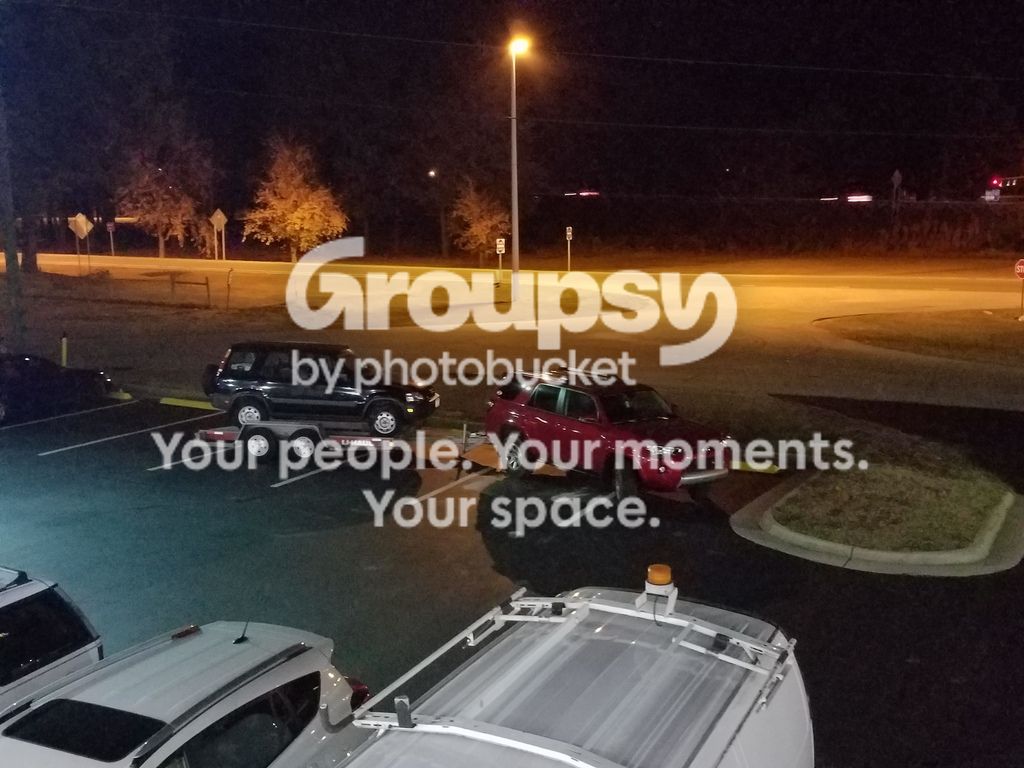

Some pics of the setup:
20161122_173637_zps1lsgzffx.jpg~original
20161122_174107_zpszs4vygcq.jpg~original
20161123_232916_zpsmp2ajhh6.jpg~original
As far as towing goes, I do have a good amount of experience. My previous 2014 taco I did quite a bit of towing at its limit (6500lbs) and had a great experience with it (6sp manual w/towing pkg) going from Arizona to northern California (over the grape vine). Looking forward to exploring the 4runner's real capabilities.

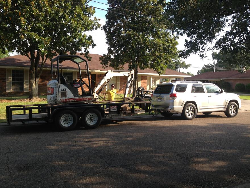

Didn't know the weight of this before I hitched to it, it was more of a "yea she'll pull it no prob.":fear:
She did so, very slowly and let off the gas about a mile before each red light.
Google says it's about 3600 lbs.

what exactly was the point of all of this, to be able to use a weight distributing hitch?
i ask because it didn't look like you were using a weight distributing hitch in your photos, so i'm not sure why you would go through the trouble
Clearly you haven't done much research. Much less read this whole thread...
The reason the 5th gens are limited to 500/5000lbs is because the hitch is bolted to the rear cross member, not the frame. A frame mounted hitch (like the 6000(without WDH)/7300(with WDH) on the 4th gen, V8 standard, V6 option) in addition to having more contact points is able to better distribute the weight between front and rear, therefore allowing for pulling of a heavier load -- however, this is at your own personal risk. What I have provided is for educational/information purposes only.
Because the frame is essentially identical to the 4th gen, even having the factory threaded holes for mounting of this 4th gen designed hitch, you can utilize a better designed 4th gen hitch, but you take all of the risk if you do something stupid and mess up your truck or kill someone.
if you overload the stock 5th gen hitch, it'll probably bend the cross member, or worse.
But seeing as you comment before reading, I wouldn't recommend you mess with your hitch at all.
