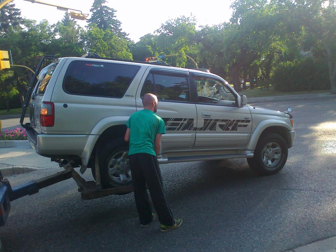

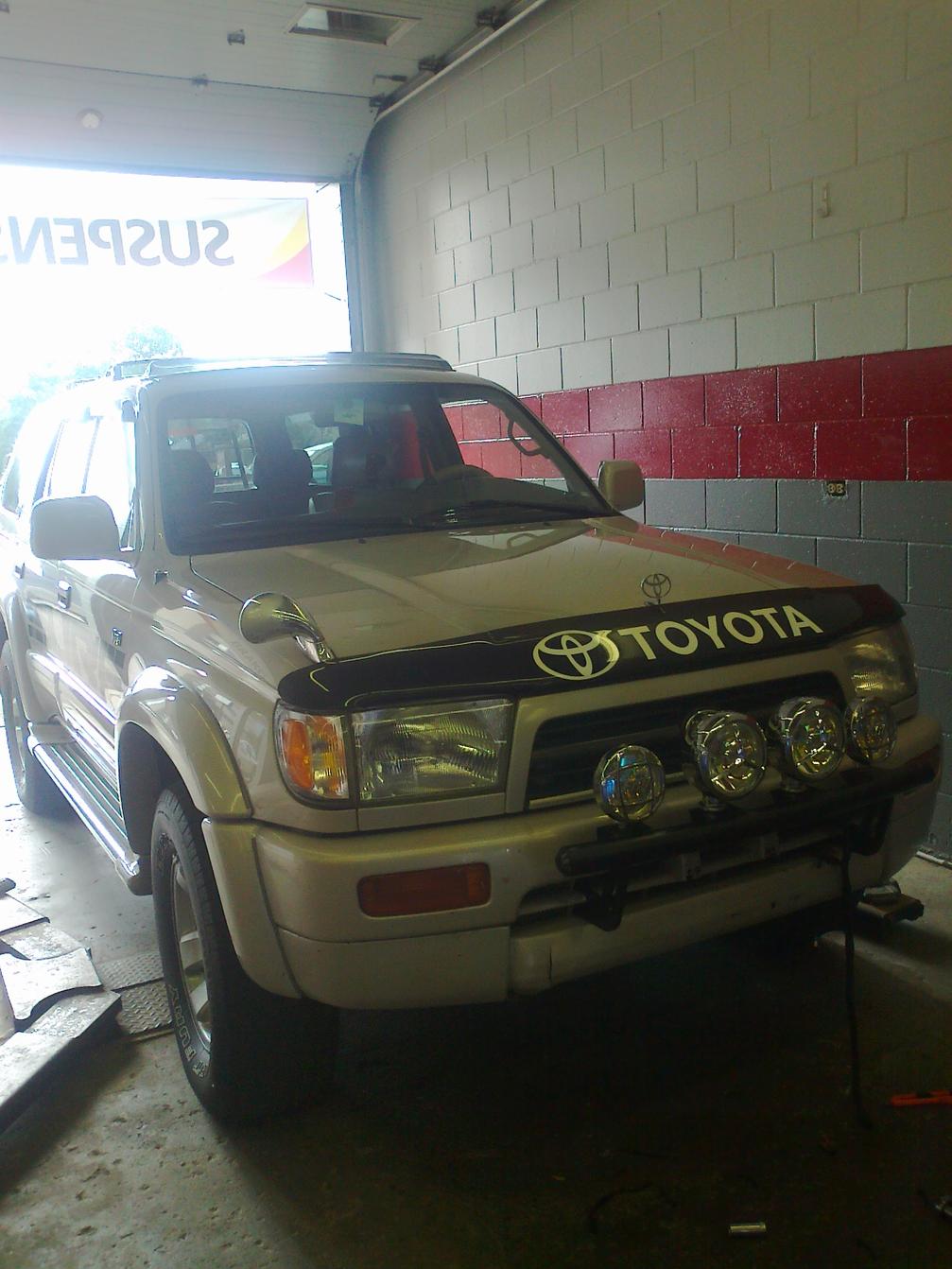

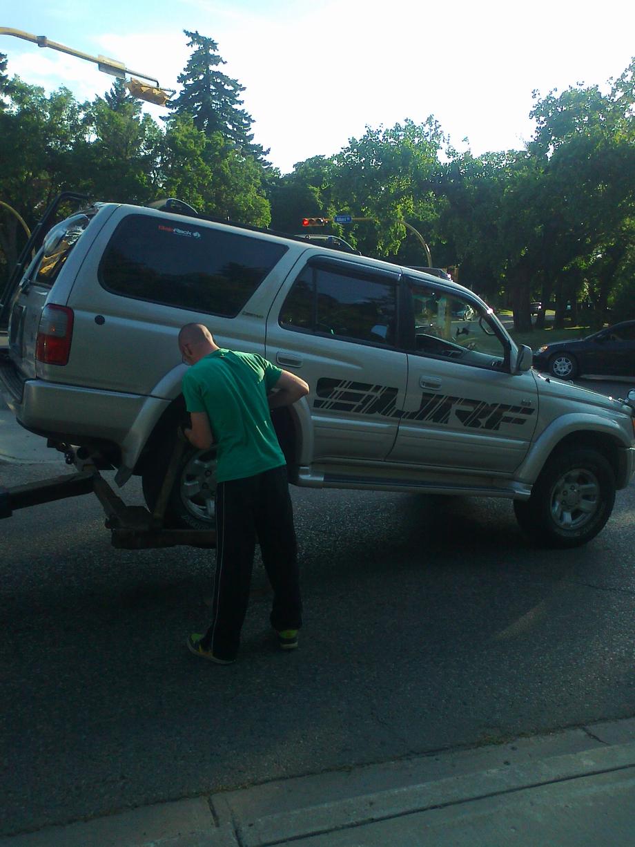

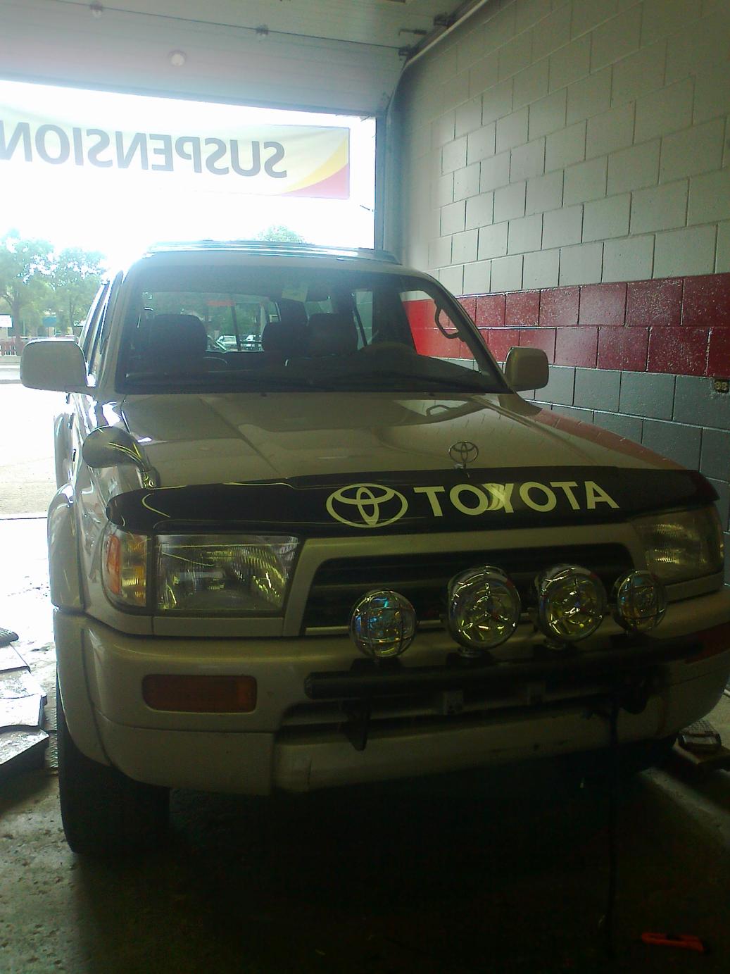

Hey guys, had a very sad day today, which was supposed to be a happy day.
This is what happened. I got my Defiant light bar last week and I was super happy. I went out to an auto parts store and bought 4 spotlights for the bar.
I made an appointment with my auto service centre to get the bar installed today. I got a call back in 4 hours saying the runner is ready for pickup. It was just looking awesome with the bar and lights. Drove it for 20 minutes and all of the sudden saw heavy smoke coming out under the hood and smelt like burning plastic. Parked it on the roadside and opened the hood.....lots of smoke came out. Tried once to start the truck and it totally refused...:(
All the lights were running fine, so the battery wasnt dead.
Called the tow company and towed my runner back to the service centre. It was already 7 pm and the location was closed, so I just left it there.
Any idea what might have gone wrong???

Got a phone call from the shop and this is what they said. They said the wiring that they did for the lights had nothing to do with it and they checked that all the wiring and fuses were ok.
They are blaming it on the Best Buy as they did the wiring/install for the remote start. They mentioned that the wire for the remote start was laying on the engine and when the engine got too hot the pastic melted and the copper wire was touching the metal part of the engine and caused all the short circuit/smoke and problem. I am like what....as I drove it only for 10 minutes.
But I am surprised as I installed the remote start from Best Buy almost one and a half year ago and I already drove 15k miles since then and never had any problem. I am wondering as the shop guys did the timing belt, ac belt, spark plug replacement on my truck couple of weeks ago they might have moved the wiring for the remote start around and thats why all this problem happened :(.
They also said that the short circuit might have blown the computer and thats why its not starting now......they are giving rough estimate on the computer replacement around $1k....wtf............
