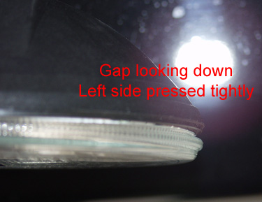

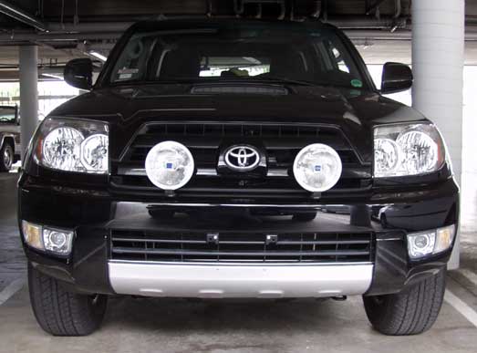

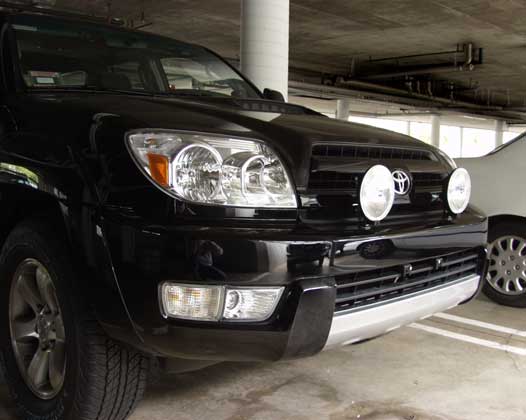

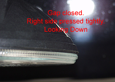

I'll shoot some better pics, with better backgrounds, but have to get to work soon, so these will have to do for now.

Hella Gap Problem
Here's the question I submitted to Hella Tech Support, and then the reply I got back....so maybe no big deal;
Hello,
I just bought your 500 series lights.
I'm noticing that when I hold the plastic housing, and press on the sides
of the lens, the Lens / Lamp assembly rocks back and forth a bit. In
other words, it's not a real tight fit, and I'm worried about rainwater
getting inside.
Is this normal, or are my lights defective?
Thanks very much,
This is a normal occurrence. Do not let it bother you. If water or moisture
should get into the lamps, let me know. If you want, you can try and seal
it up with some glue or apoxy.
Thank you!
Scott Kornhaus
Consumer Support Rep.
Hella, Inc.
201 Kelly Drive
P.O. Box 2665
Peachtree City, GA 30269
Hella, Inc.

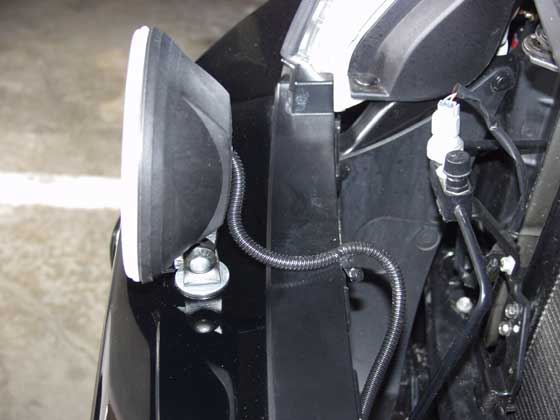

Mounting...
I drilled pilot holes, then bigger ones, right through the soft plastic, and harder plastic below, of the bumper. Be careful that you don't hit the many plastic re-enforcement pieces though, as there are many underneath. I used a large rubber washer against the plastic, to avoid scratching, and a larger one above it, to spread the support, otherwise it would rock back and forth a bit. Another washer below, although a bit smaller.
Also, be very careful to allow enough room for the hood to open. The grill opens out just a bit, so you need some clearance.
I can take some more pics, including the cabling, if you want.
Also used some grey rubber nipples over the Hella adjusting nuts, to hide the nut.

Pics, would be great especially close ups from the sides.
