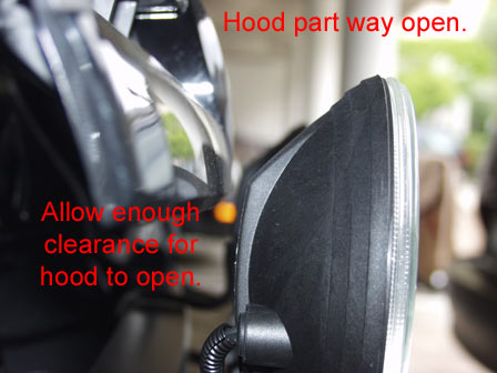

Hella 500 Lights....housing fit.

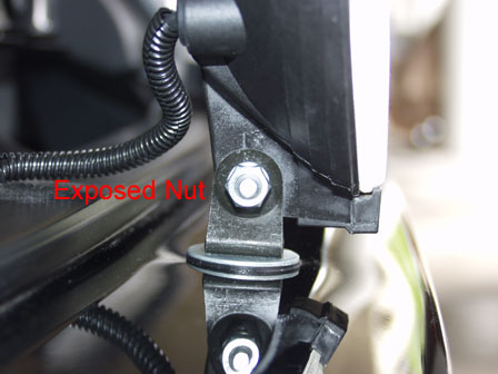

C.U. before covering nut with rubber nipple.

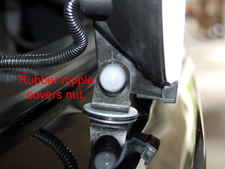

With rubber nipple from Home Depot.
Would also be nice to find a black washer, that matched the rubber washer below too.
