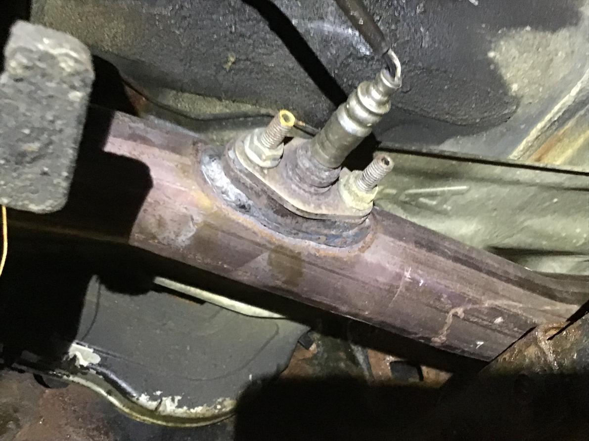

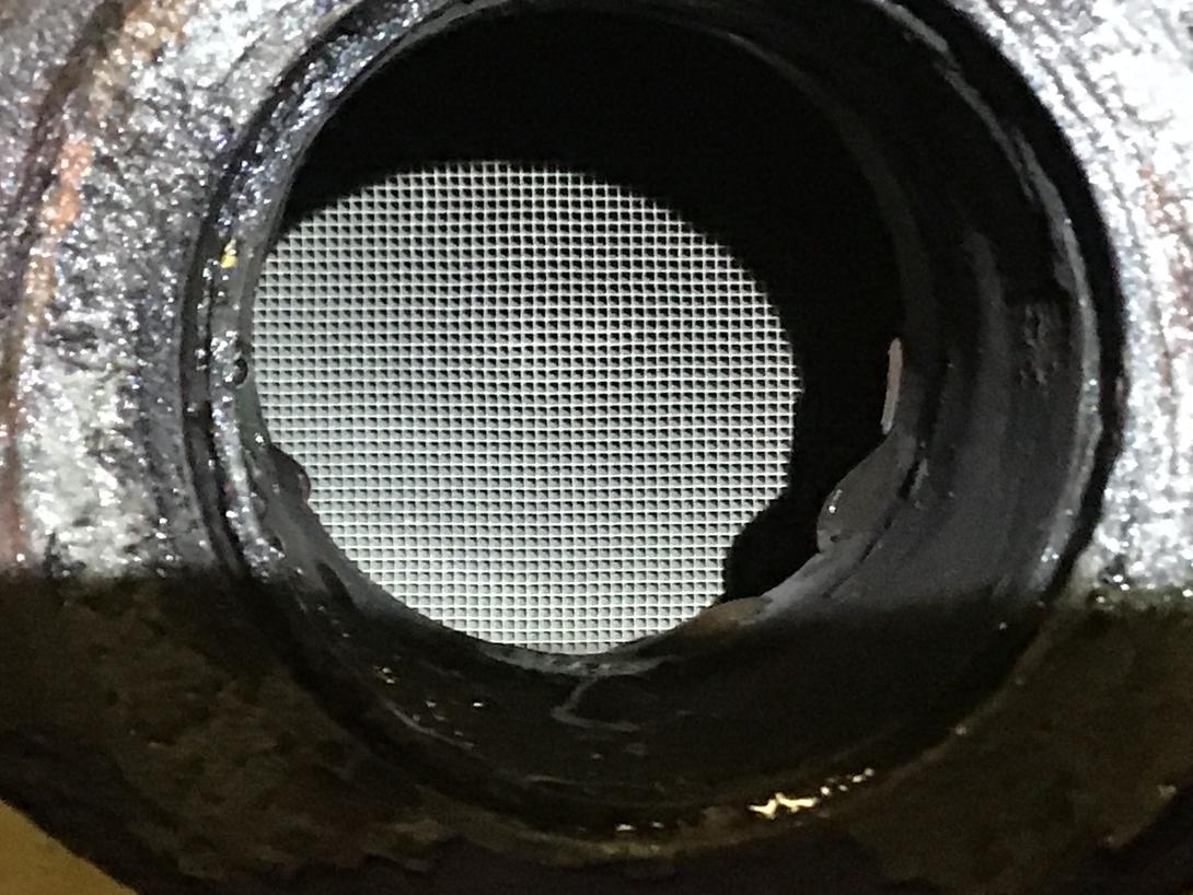

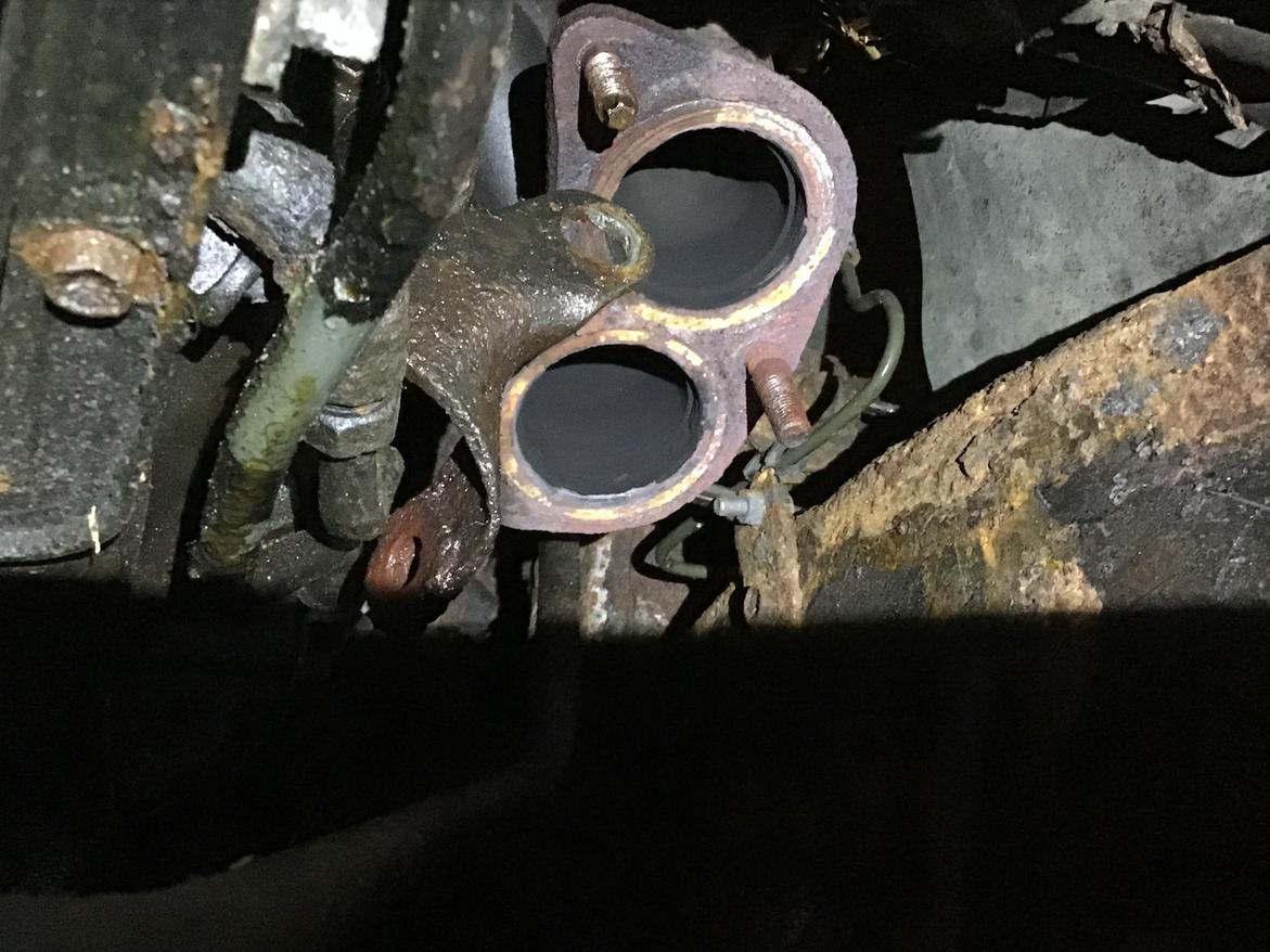

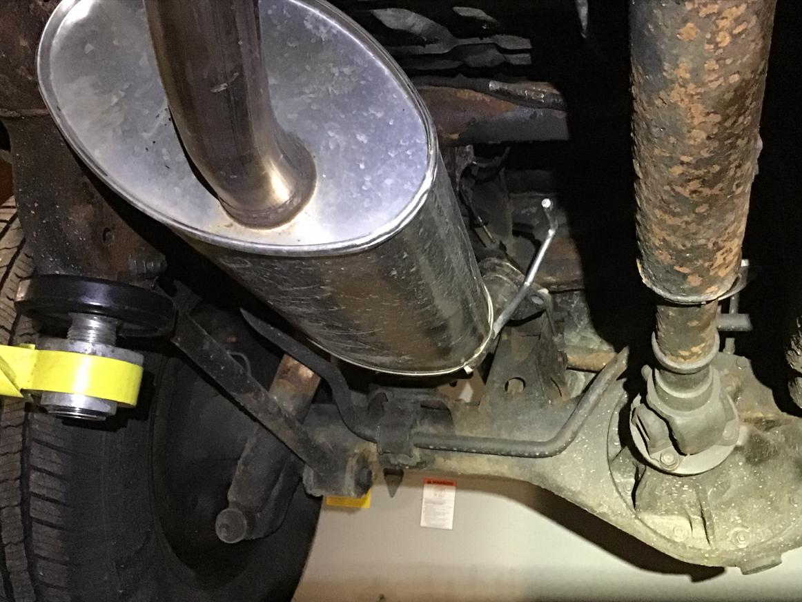

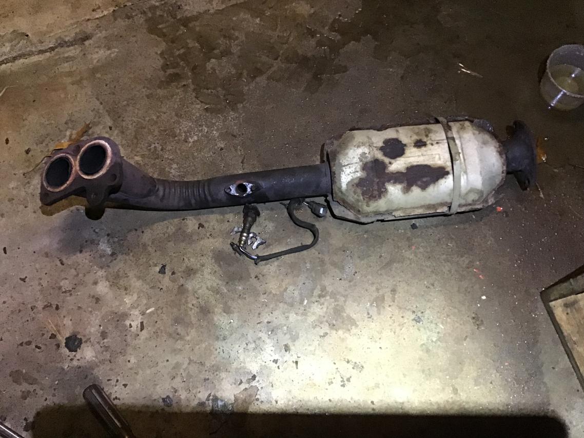

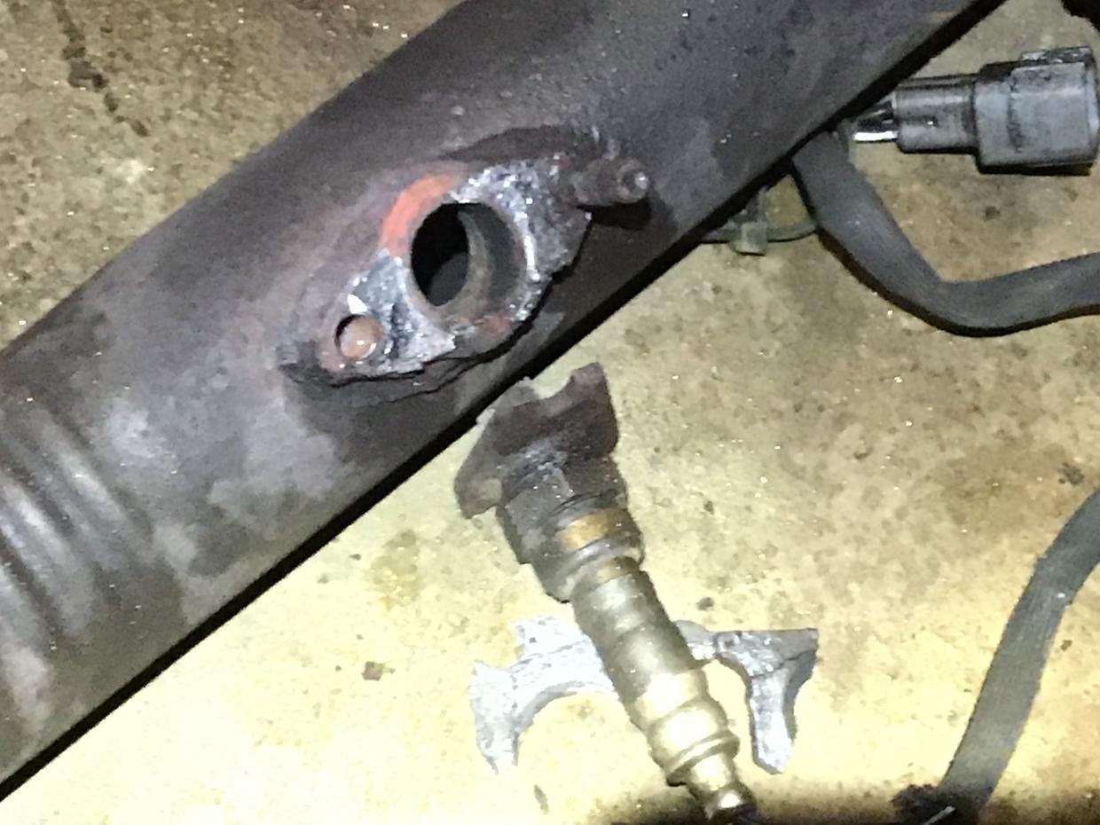

I have the 4 runner on the lift and remove the catalyst. Wasn't as bad as I expected. To my surprise the bolts were not seized (very unusual!)
I guess the cat is open and not crumbled inside but I have a clear view only to one side.
The Cat itself is not in great shape but also not too bad. It is not a Toyota part but aftermarket . on the heat shield it says Made in USA.
The upstream O2 sensor (front, in the Cat part ) looks older and the plate broke off when I wanted to remove. So this part is sketchy.
Question is...as the parts are out now... I'd better get a new cat and get over with?
This depends on cost obviously.
What is a decent quality aftermarket Cat product? What brand and where to buy?
As I said I ordered 2 new O2 sensors already.
Attached a few pictures, Cat removed
