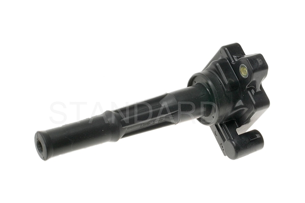

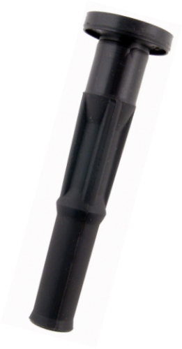

If you didn't get boots for the coils you should order them and do it all.
Thanks, as you know I have the new NGK ignition wire set ,
for the coils do I need
** Direct Ignition Coil Boot-Coil on Plug Boot NGK fits 95-04 Toyota Tacoma 3.4L-V6
Part# 58931
Please confirm that these are the boots that need replacement for the coil at cylinders #2,#4 and #6? (maybe I have the cylinder numbers confused, forgive me)
Martin

I thought the NGK set came with the boots for the coils too.
Thanks, yes of course the NGK wore set comes with new boots, all agreed.
My question however is about changing the boots on the 3 coils, which I suspect highly as a leak point. Again my question: are the boots on the Toyota coils exchangeable? And if yes is part # 58931 correct to order?
If not exchangeable i‘d order new coils (Delphi brand, set of 3 for $150)

They will mount to your existing coils.
