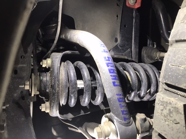

J JTDeel New member Dec 24, 2019 #1 What do I do wrong? YouTube I Think this is the source of my squeaking noise. Edit. Noticed in the video i have the smaller washer up top instead of the larger one JT Last edited: Dec 24, 2019
jk24runner Member Dec 25, 2019 #2 Here is a pic of mine if it helps Attachments 823BA9A9-45C9-47FD-B090-8E8CEDB5002F.jpeg 101.9 KB · Views: 435
A ABDave New member Dec 25, 2019 #3 There must be something missing in there, looks like the big rubber on top of the spring is not there. You have way too much treads sticking pass the nut on top of the shock. Sent from my iPhone using Tapatalk
