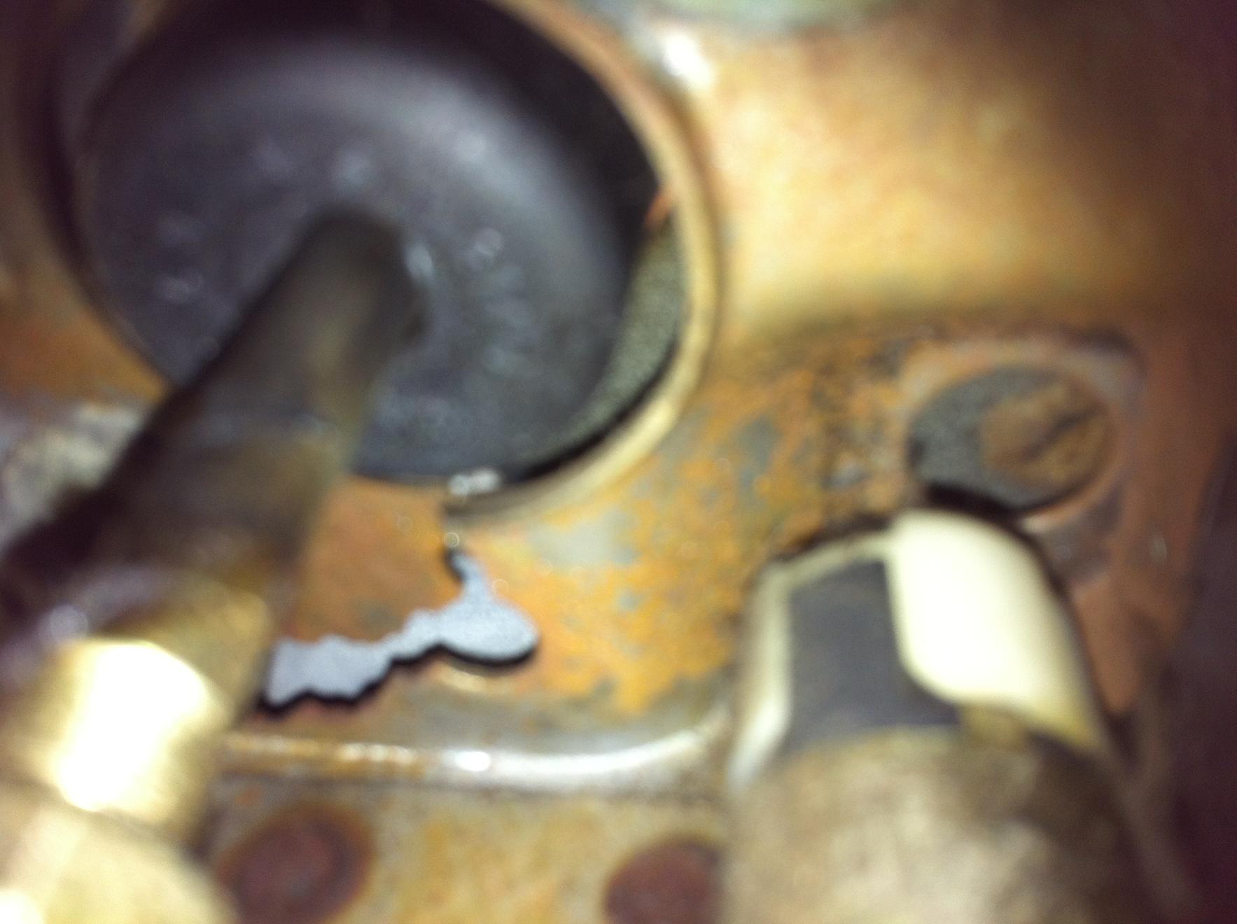

Got the package from Marlin Crawler, and got to thinking...didn't I hear a creaking sound from the clutch pedal before it stopped working on me?
Thanks to this forum we all know what that means...see attachment. Sorry for the poor photo quality.
Looks like I'll start pulling the clutch/brake pedal bracket out. And see if someone can weld it up for me.
Anyone see a solid walk-through on pulling this beast out?
