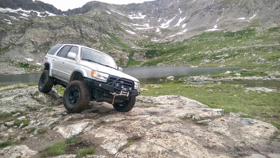

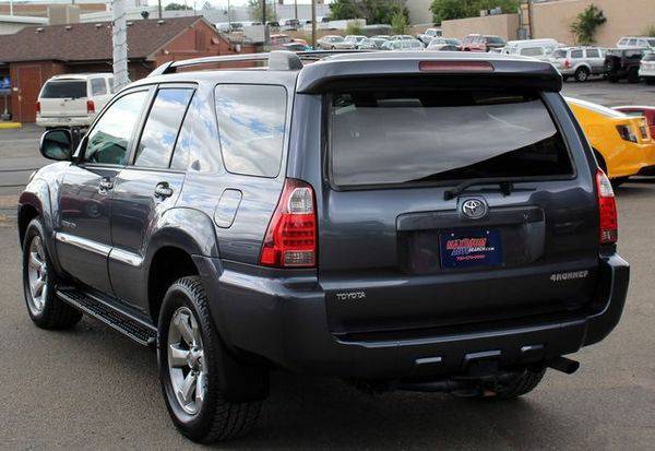

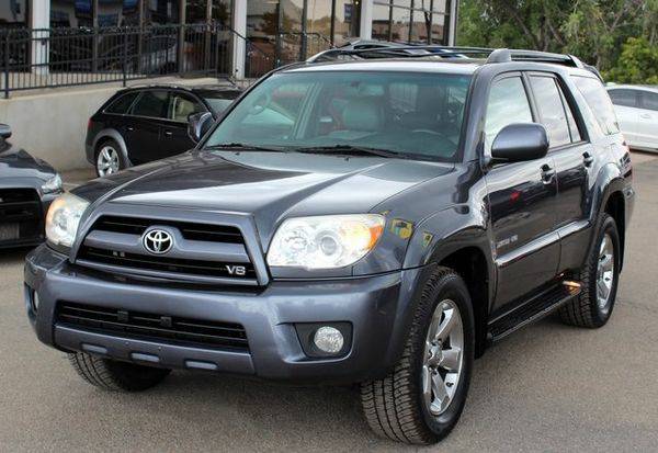

So my brother just picked up a 2007 Limited 4runner. Its pretty clean. He is about to drop a lot of money on some parts and asked me to help him out. Money is not really a huge issue. He wants to be able to keep up with me and our buddies and also wants to out do us a little on his lift. So after my research this is what we have planned on purchasing.
1. Icon Stage 2 Tubular lift kit.
2. 4Crawler 1.5" body lift
3.Icon Rear shock chin guards
4. Toytec Sway bar relocate.
5.285/65/18 tires I believe he is getting but not sure
So question is what are we missing? Does his bump stops need lowered to protect the shock from over compressing, or help tires from over compressing into the wheel well?
Extended brake lines?
Does he need extended sway bar links along with the relocation?
Thanks for any help. Some pics of his new soon to be rig and my 3rd gen.

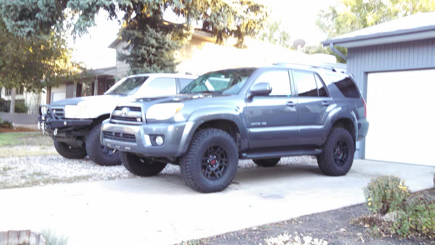

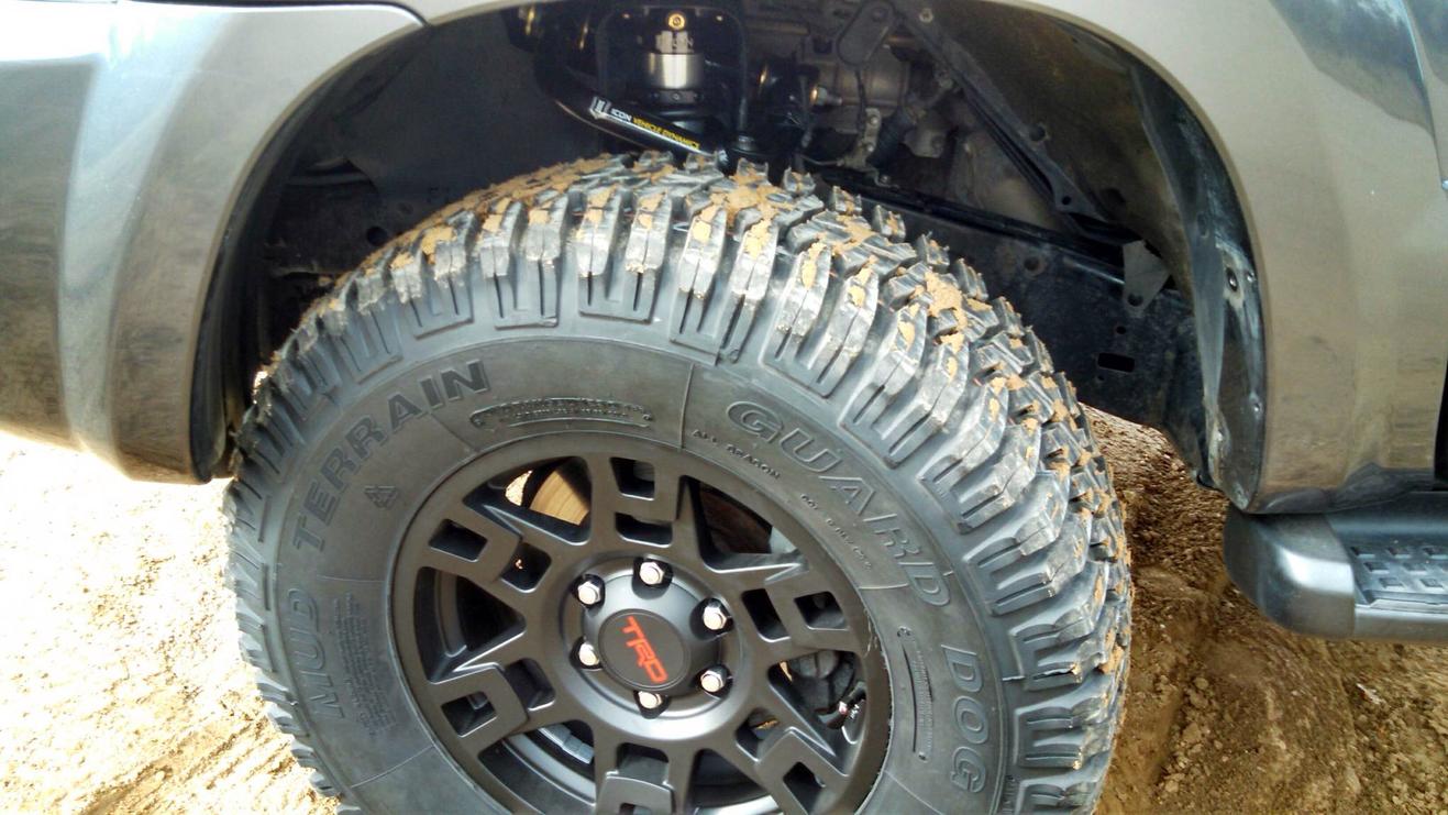

So most everything ordered up. Going to document his build. Here is final setup.
Lift:
2007 Toyota 4Runner FJ Cruiser/4Runner Rear Long Travel Kit/Icon Coilovers
Kit Includes:
58645/58647 - Icon 2.5 Extended Travel Coilovers $1199.95
MT-GSJ-4176 - Metal Tech Long Travel Rear Suspension Kit $679.85
MT-GSJ-4025 - Metal Tech 4x4 Offset Lower Links $325
2007 Toyota 4Runner ICON 03-Current 4Runner Tubular Upper Control Arms $695
Wheels:
TRD Toyota 17 Inch Black TRD Pro Wheels
Tires:
Treadwright GUARD DOG B2B LT285/70R17 (D) Tires
Will post pics of parts wheels and tires. Will be installing them here soon. I'm kind of jealous. But about to pull trigger on 2010 tacoma to compete with him for the wife.

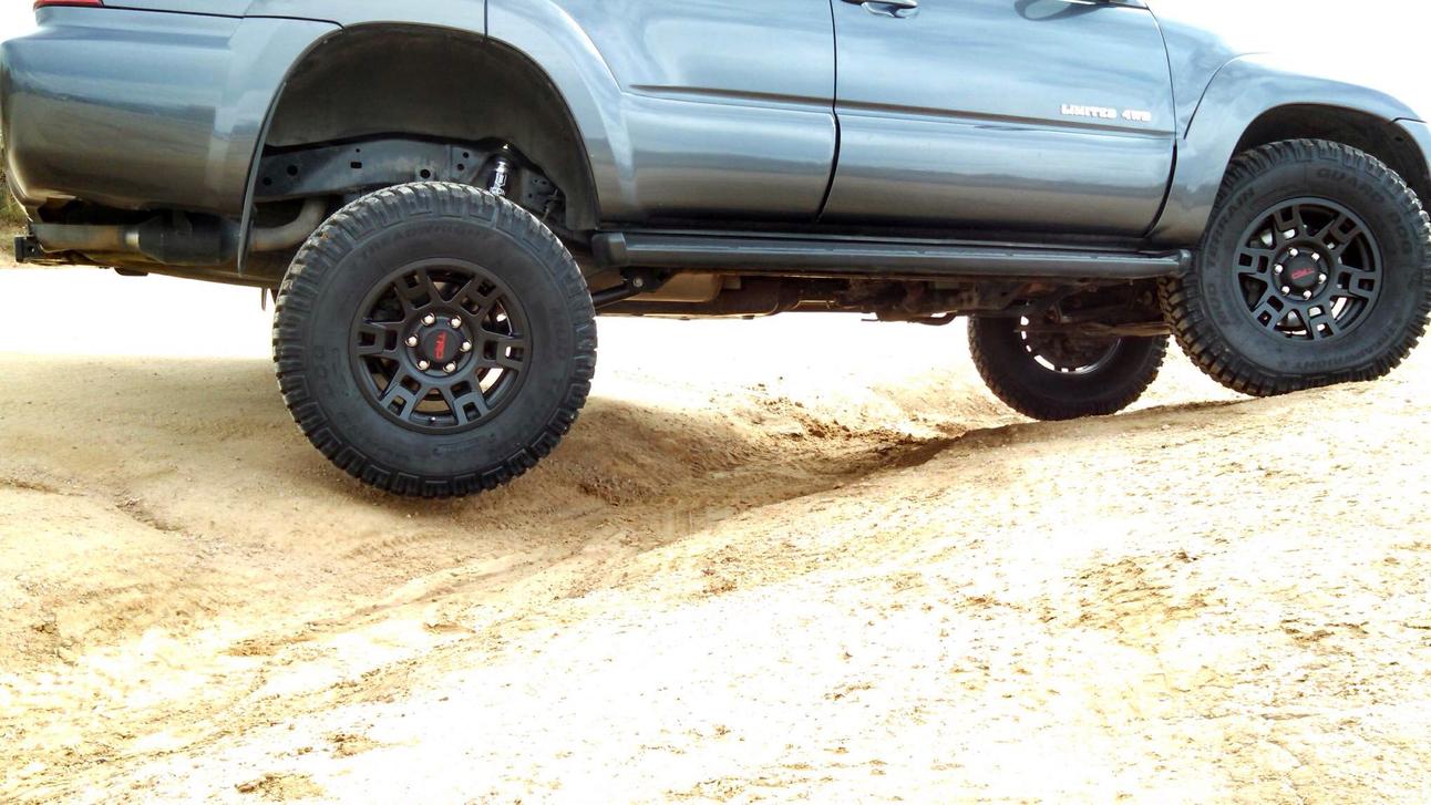

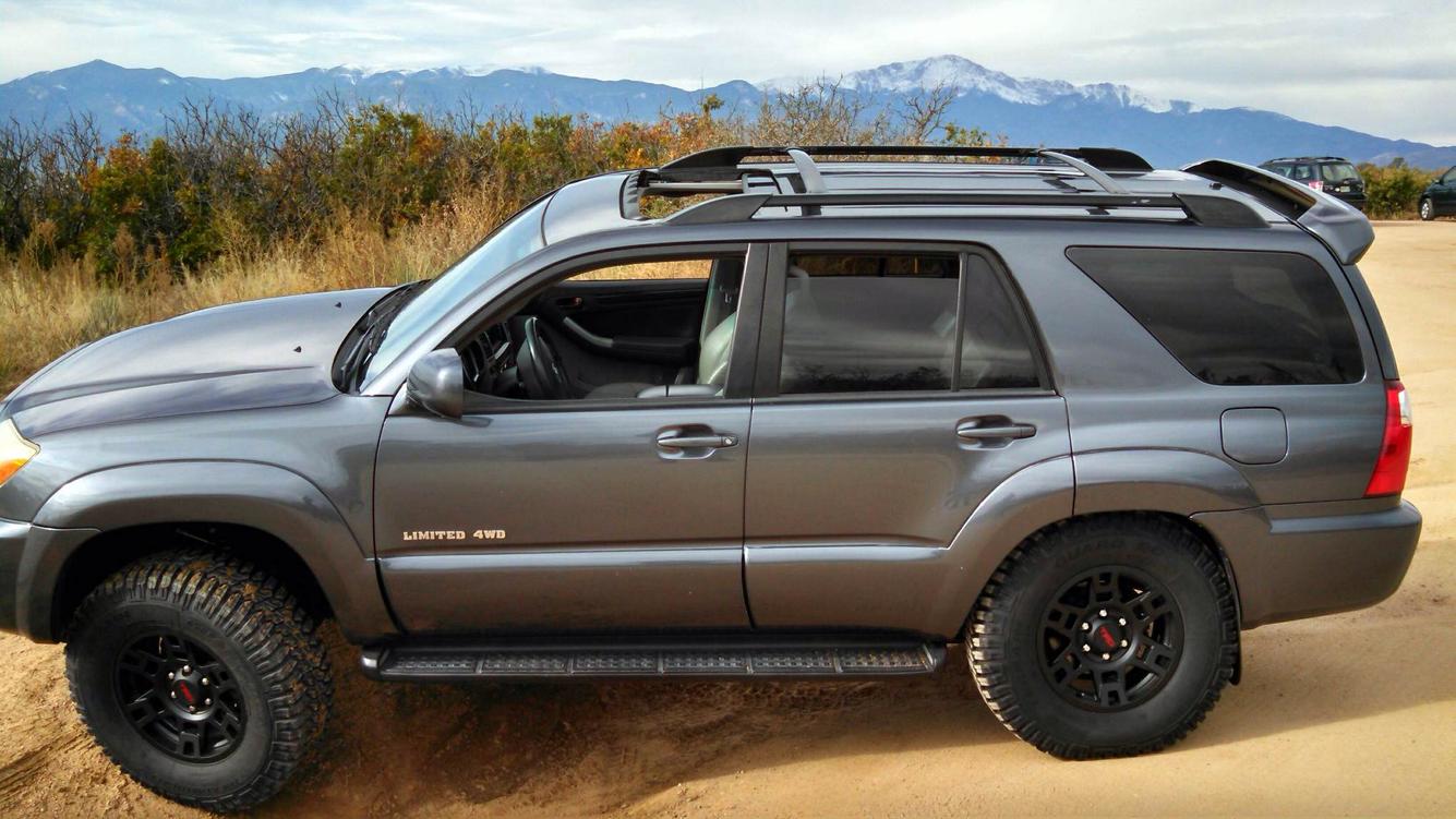

Well after lots of cussing and hard work we got her done. With the axle jacked all the way I still had to compress the springs to fit them. I have to say it rides nice. He was really happy. Now need to cut front bumper and still thinking minor body lift. Some pics first is stock.
