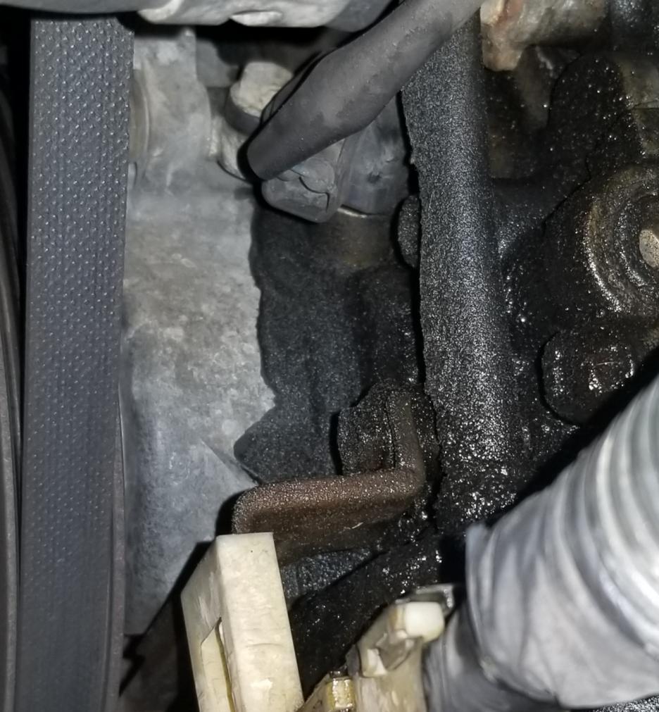

so, I came out to see a huge puddle of antifreeze under my truck and it's not coming from the hoses or radiator. it looks like it's coming from behind the bottom pulley. and the radiator is of course empty.

I agree with fourfive. That looks like the pump is leaking. :-( Especially if it is not wet ontop by the valve covers.
It's not too hard to remove the top timing belt cover and pry back the bottom one.
That will let you get a better look at the water pump.
Look like a water pump / timing belt job is in your near future. It's really not that bad at all if you want to do it yourself. A complete parts kit is in the $250 range and it can easily be done on a Saturday if you want to save some money.
Depending on where you live, the price to have a shop do it is usually between $700-1000.
update; I dont have the place or all the tools, unfortunately, to tackle this big of a project, so off to the shop she went. New hoses, drive belts, timing belt, and water pump, to the tune of $1300. :faint2: oh well, glad I didnt spent all of my Gov't check until now! thank you for the quick responses and help for my problem. this forum has given me a wealth of information and at times saved me a ton of money. y'all are a great bunch of people.

Too bad you don't have the space to work on your rig. A quality timing belt kit with everything you need, including the camshaft and crankshaft seals that I bet the shop didn't replace for you runs around $270. That means you could have saved around $1,000 buckaroonies doing this job yourself, and you can buy a whole lot of tools for $1k. Oh well, hopefully one day you'll have a garage or outbuilding with lots of space and tools to do your own work.

Bummer on the bill...I did my water pump about a year and a half ago. When I pulled it off, the pump wasn't even bad. It was the gasket. I still put the new pump on, but just goes to show you, an $800 job might've been a $15 job.
