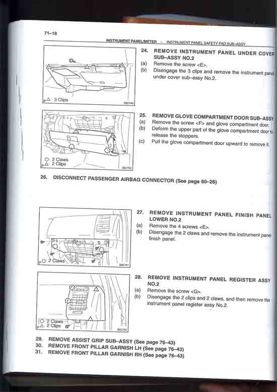

Hey guys/gals, I'll be putting into motion my plans to build a carPC. If anyone with a service/repair manual can please provide the instructions on how to remove the glove box and the hidden compartment inside the glove box, it would be greatly appreciated. Thanks!

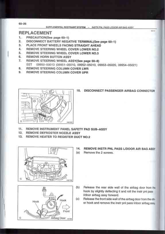

Just checked ouy my Toyota 04 repair manual. Basically just unscrew all the visible screws. Remove glove box door first. Then hidden box. unplug airbag. Make sure the batt is disconnected before you do that. that's really all there is to it. everything should pop right out.

thanks! is the airbag attached to the hidden box?
Not sure about the above question but IF you have to do ANYTHING electrical with an airbag/safety circuit make sure to follow the warnings in the elctrical manual. WAIT 90 SECONDS after disconnecting the negative (-) battery cable before performing any work. The SRS is equipped with a back-up power supply that may deploy the system if you don't wait the full 90 seconds.

thanks for the tip......i would hate for the airbag to deploy.....:bash:
