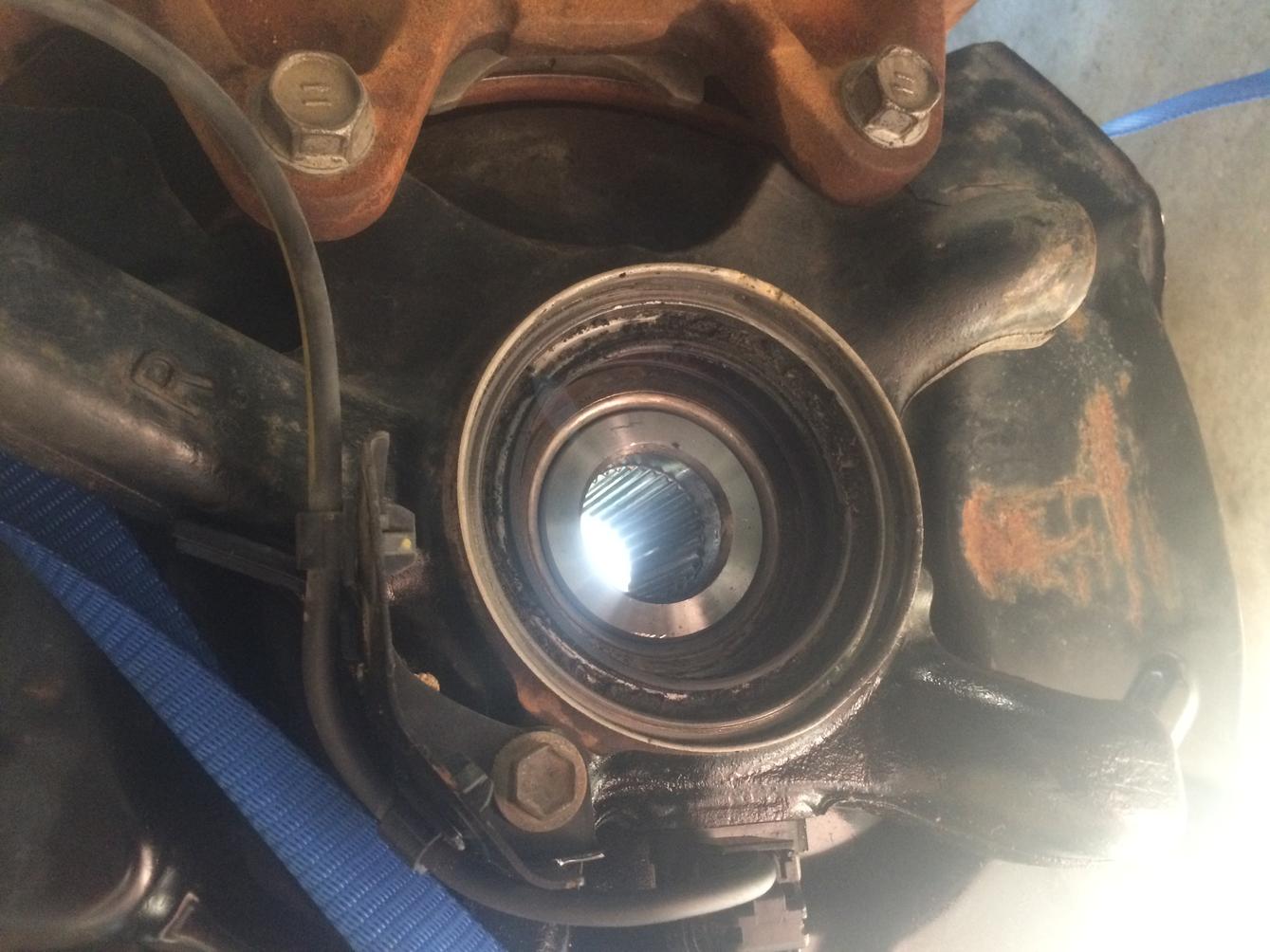

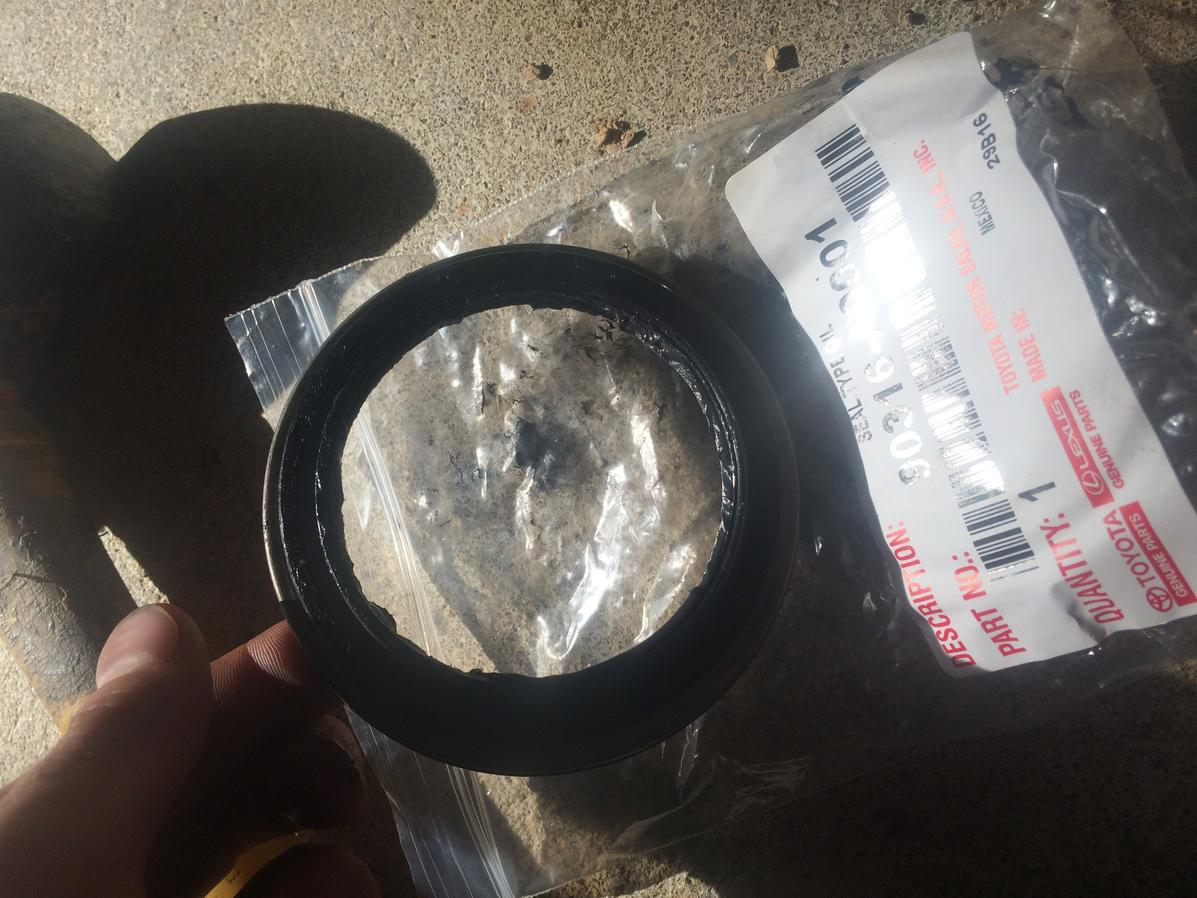

Replacing CV, and discovered the seal at the hub is destroyed. Thankfully, I planned ahead and have one handy. However, I haven't replaced this one before, and it's pretty heavy duty: metal ring plus rubber seal portion.
Is there a good way to remove/ reinstall this guy? (PN 90311-A0001).

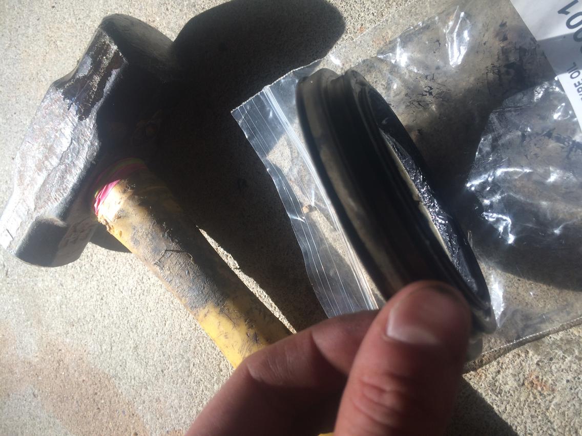

And another (sorry for all the posts, my phone calls them all "image", so I can only upload 1 at a time):
I had issues with this. The manual calls for a special tool and press but I made due with an old metal coffee cup that was the perfect circumference for the seal and used a 4lb hammer to seat it fully.
Thanks! I actually wound up using the old seal on top of the loosely fitted new and just tapping with a hammer. I figure: doesn't matter if I damage the one that's about to go in the trash.
One axle down. One to go tomorrow...
Hey, i just tackled this a few weeks ago. I had trouble finding the parts. Thank God for the forum.
The removal was easy.
The install was not bad either. Most people press them in. I just used a dead blow hammer and pushed the top rim into the knuckle then worked my way around the back of seal with the hammer. Went right in... no issues.
