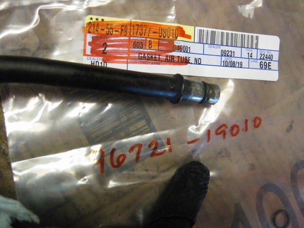

This is my 2wd dipstick where the O-ring is after pulling it out.
346967d1572201696-trans-dip-stick-tube-top-stuck-bottom-wont-come-out-mini-2019-10-25-10h50m37-jpg
