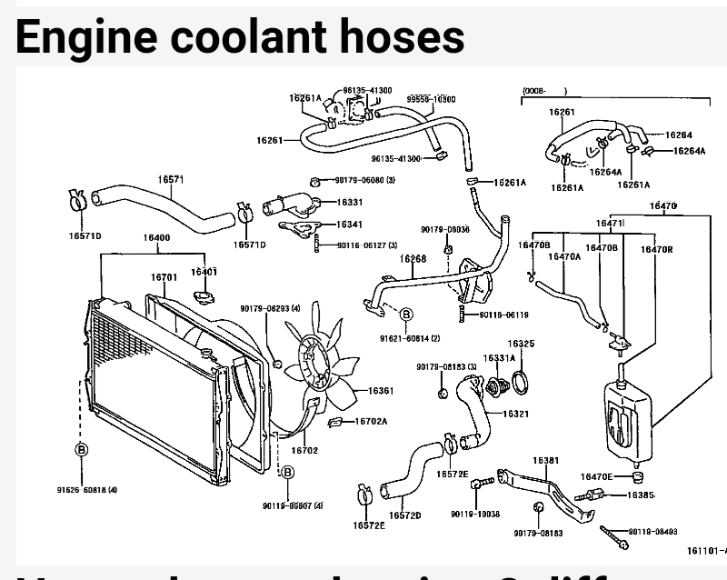

There is a coolant bipass pipe under the intake in between the heads in the valley. It is rtv'ed in the front and runs to a foam gasket in the back which collectsthe coolant and drips. A telescoping mirror would come handy.
There is a pic of the tube in the following thread.
Help - coolant in the valley - why?
Here is a diagram of the coolant pipes per the fsm.
Thanks for your reply and that diagram, I'll be sure to check it out.
