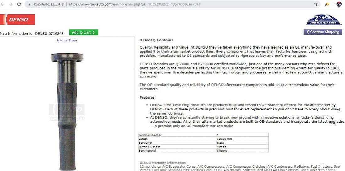

Most times its just cracked coil boot arching out. Electrical parts of coils either work or they don't. The boots can be replaced on their own. Denso coil boots are cheap, they are coil boots/plug boots. Get a set of 3 on on Rockauto, should replace whenever you replace your plug wires.

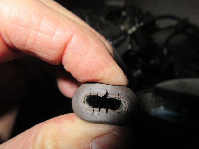

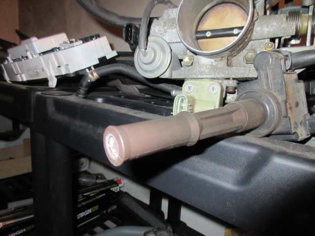

I happen to have a bad coil boot in my hoard of crap. Here you can see I squeeze it and you can see the cracks. This is how old coil boots get cause they dry out. The boots pop off the coil and you can replace them as my earlier post stated.

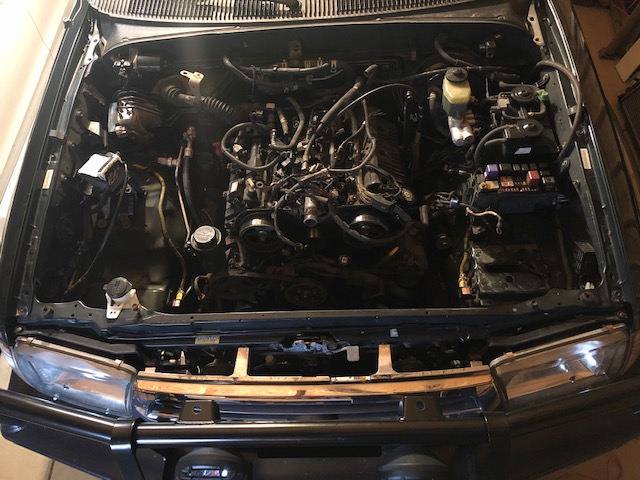

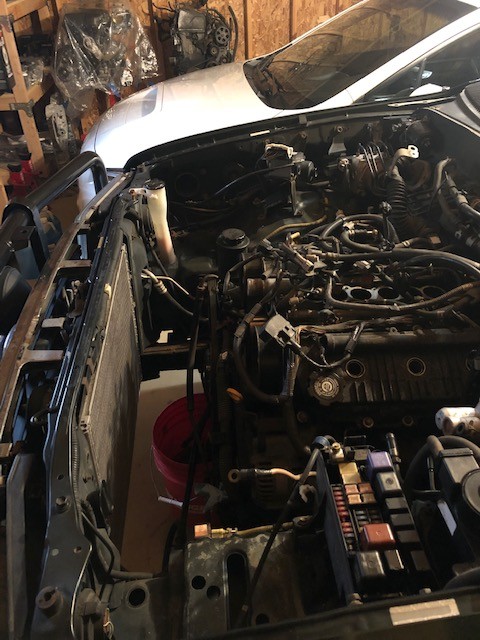

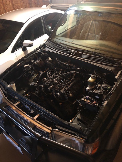

I found a coolant leak along the lower intake manifold and around the water pump. Huge job and not worth buying anymore parts for this old motor. So I have decided to pull the motor out and replace/swap (See pics below). I am deciding whether to go with another 5VZFE or do a different motor swap. I like the idea of 1UZ or 2UZ, but I am not sure the complexity of those swaps. Right now, I am prepping the bay to remove the engine. Anyone have any advice on removing the trans, exhaust, and engine mount bolts? Probably gonna create a new thread on this next venture. Thanks.
