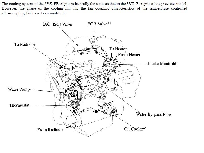

In the area behind the alternator is a oil cooler line that runs to the water pump near the water neck that houses the thermostat. There's a chance it's just that hose leaking and the water pump is fine. This is a hard area to visualize so maybe pulling the alternator out of the way to get a better look would be the way to go.
Check out the picture below and you'll see the hose I'm talking about that runs from the oil cooler to the water pump.
