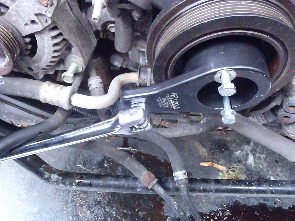

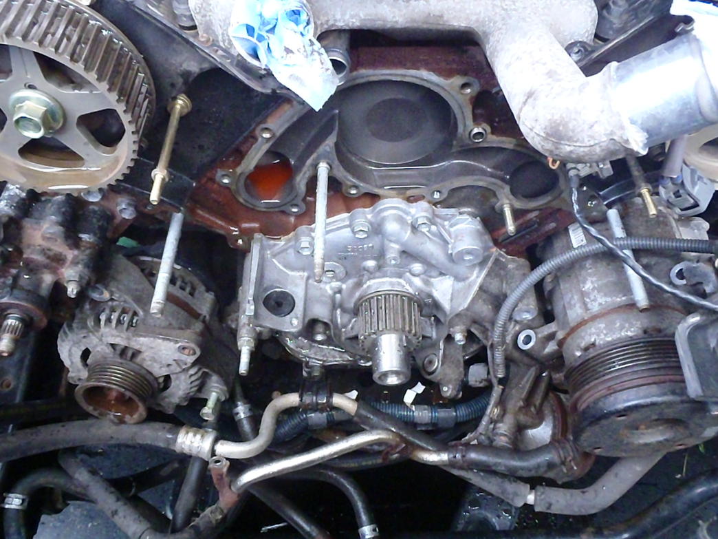

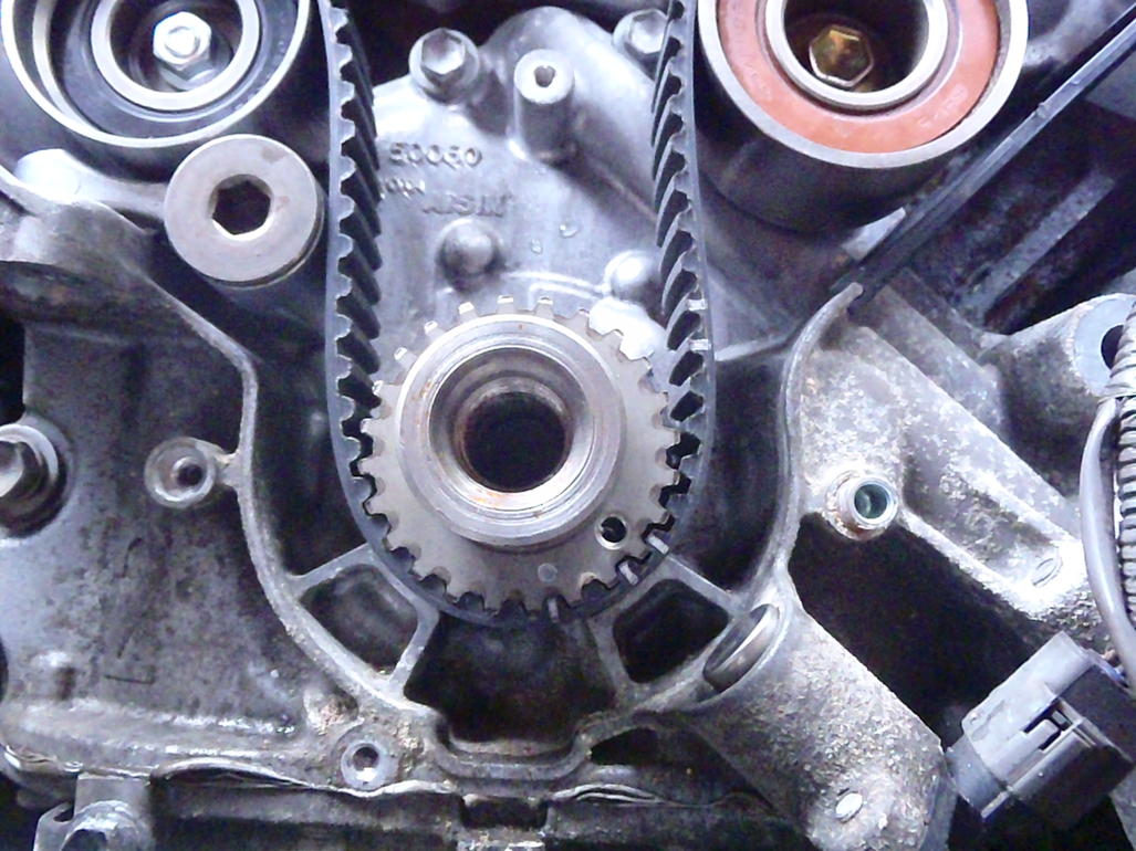

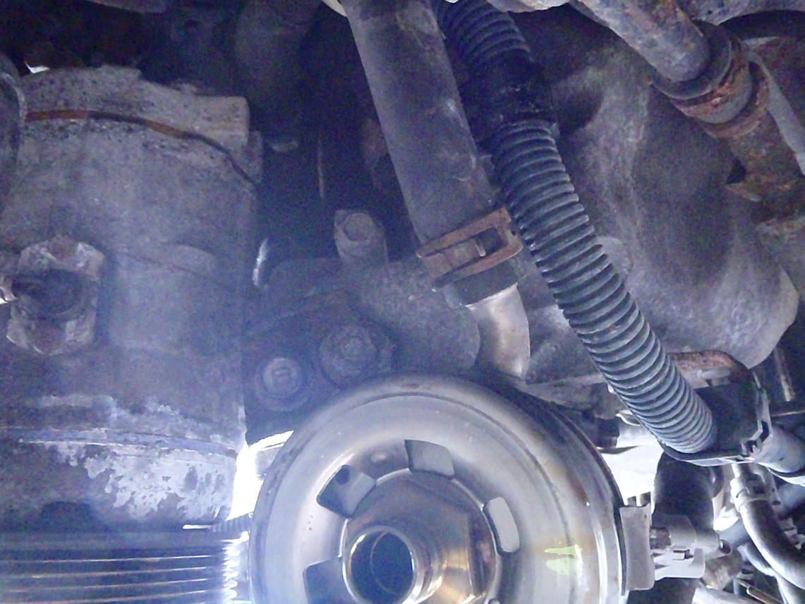

I took plenty of pics, but here are a couple:
http://www.toyota-4runner.org/attachment.php?attachmentid=91038&stc=1&d=1371091134
Awesome tool!! Definitely worth it's weight in gold.
http://www.toyota-4runner.org/attachment.php?attachmentid=91039&stc=1&d=1371091155
Everything stripped down:
http://www.toyota-4runner.org/attachment.php?attachmentid=91040&stc=1&d=1371091202
Two bolts hiding behind the oil filter

  • Crank Bolt - Like many before us this was a major PIA... While we were finally able to get it off by taking out the radiator and using an impact driver we still needed a tool to get it torqued back to spec.... IMO this tool Schley (SCH64300) Lexus and Toyota Harmonic Damper Pulley Holding Tool - Amazon.com
  • is well worth the money... If we had this tool from the beginning, I'm convinced we would have been fine....

  • Power steering pump - Could not access the bottom bolt with out removing the oil filter.... We had planned on changing the oil anyway but wanted to mention that you want to be sure to leave the filter off until you get that bolt off and later back in place....

We ended up pulling the radiator and using a 900fp impact driver to get the nut off but even with this approach you need either the homemade tool or the one we bought to be able to torque it back....
