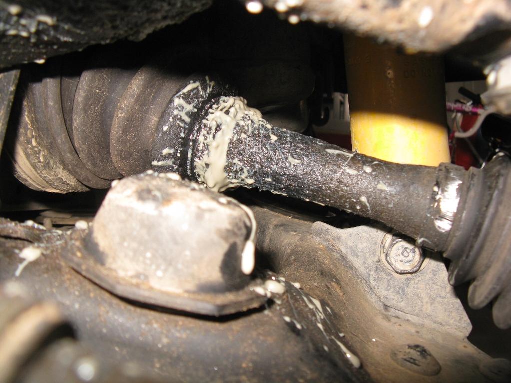

So I had my buddy do my lift install for me 9 months ago. He is an autobody mechanic and a wheelin friend but deals mainly with Jeeps. He installed the 2.5 front OME suspension lift for me. It came with the diff drop kit but not knowing what I am even looking for I dont know if he installed the diff drop kit.
Can someone send me a pic of what to look for to know if he installed the diff drop kit or not. When I asked him he couldnt remember if he had or not.
Anyways when we upped the suspension to the 882's this weekend along with the 1 inch body lift the inner CV's just let loose.
My local shop in So Cal says $625 for two new axles. Is this a good price and since they are totally replacing them how long can I drive on these leakers?
At least the lift looks good but I sure could wait a few months to shell out the money for new axles!
Thanks Dave

oooooo noes!!!!!!!! lol
your cv's are fine, just squirt some more grease in there and zip tie them at the tops, just cause the boots are torn or they are shooting grease doesn't mean they are bad, it's just the change in angles squeezing out excess from the joint, due to the increased angle.
that said there is a very good write up on how to fix this with a few c-clips and some grease but it's alot of work, most people just get some sort of pipe clamp,steel zip tie, or something of that sort to reseal the boots at the top.
keep your $689 or whatever and use the power of google!
Let me google that for you
p.s. i have nearly 2K with 4 blown boots zero grease and only a minor whirring noise, lol

FWIW: The 1" diff drop only drops your CVs ~.5", so the angle is relaly not going to look much different/
look for the two big bolt heads hanging down right by the diff if you see a couple of pucks in there you got the diff drop.

That price to replace your CVs is waaaaaayyyy off! They are ~$85 each at Napa for the lifetime warrany CVs and it takes about an hour or less per side. So if a shop charges $75/hr labor (xs 2 hours), your looking at ~$350 OTD.
I highly suggest replacing your own CVs though because they are easy and it's a good thing to know how to do anyways since this is one of the more common problems that can happen out on the trail. Save your old CVs for backups (you may look and see what it would cost to re-boot them), but even with the old boots, they will work great as backups for the trail.
There's nothing wrong with your CVs just because they are leaking grease either, most likely they will still last for up to several more years. I would put hose clamps over the existing clamps and try to tighten the boot back down before you pay $$. Just make sure the hose clamps don't rub the side of the boot and wear into it.
Okay good the pucks are in there!
How do I apply the metal clamps? Does it come with instructions? Do I just clean off the area and stretch the boot and then clamp?
I was saying to get some normal hose clamps (like the ones you have on your radiator hoses) and slap those over the existing CV boot clamps. A screwdriver (or a nutdriver preferably) is all you need.

What about the color of the stuff coming out?
Mine is doing the same since the lift and I thought it was water/grease mix (hence the milky color)...
I happen to have some of the Stainless Steel zip ties i can use but didn't want to go through the hassle of sealing it up if it was going to be a problem in the near future... I would still like to stop the spread of crap on my suspension parts.
the grease should be a pale yellowish, like over processed chicken or something color, lol
