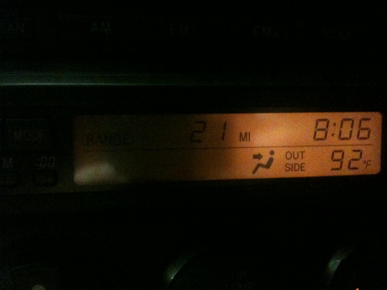

The backlight is out on 1/2 of my center display......Anybody know how to fix this??

This has happened in mine, even the same side. I've followed the links for bulb replacement but I want to make sure what I need to order. Is what's in the picture above an LED or a bulb?
The pictures in the links only show the replacement of the climate control bulbs and not the computer display, or am I missing something?
Its a regular bulb, not an LED from Radio Shack. The Toyota part number for the Temp/MPG read out screen bulb is 90010-09017.
Yup that part number is right. I did this yesterday. Took 10 minutes.
