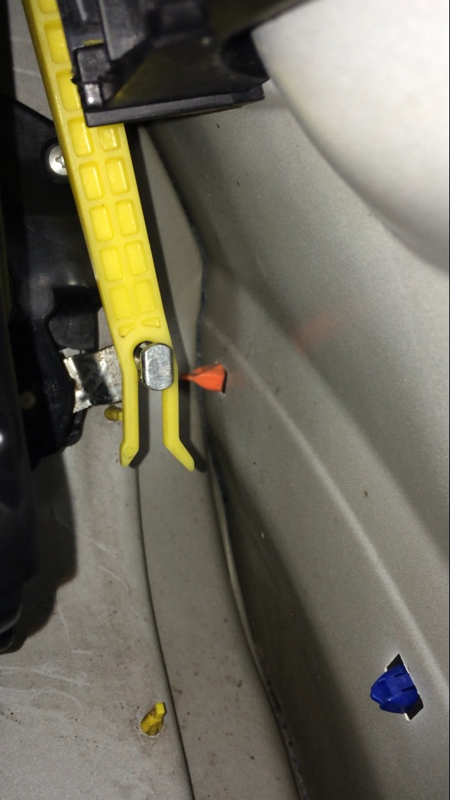

Ah, the yellow vertical 'lock rod' is I think what you are talking abt. I def didn't hook that up correctly. I think that will be relatively easy to get to with an arm. If pushing it up opens the door from outside, then it may be doable! Thanks for the advice. I'll try to take a pic or video since I haven't come across a clear one of the lock rod functioning.

So now I can open the door and I get the actuator all in correctly, and find out the re-built actuator I bought on eBay doesn't seat into the lock rod correctly. It's loose and makes it where I really have to heave on the outside door handle to get it to open (though electronically it works great). When I replaced my old non-functioning actuator just to check the fit, the door opens great from the outside. So now I'm sending back the actuator and will get to try this all again soon. But I think I'll do it right this time...thanks largely to all the advice.
Shot a pic of the vertical lock rod and how it needs to seat properly to the metal post on the actuator so will post that too.
