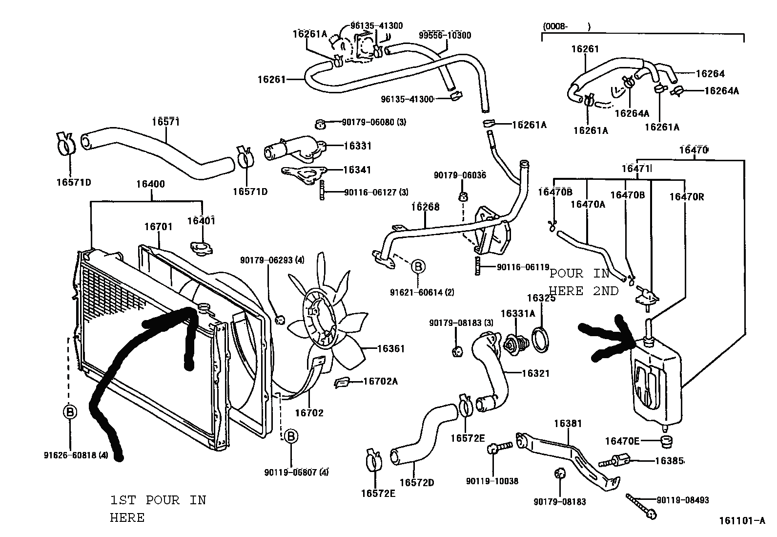

Fill it by the radiator cap. Only take off cap when engine is cool.
Being yellow in color I would guess it is the "universal" coolant. You can pick that up at any auto parts store.
Fill radiator first then check the overflow tank and fill until between the MIN-MAX line. Then drive check the overflow after a few days of driving. You might have to add a little to the tank.

Open the cap, and check the condition of the coolant that remains. If its pretty clean, fill up the radiator, run the engine with the cap off, and allow the thermostat to open. This will allow any air in the system to bubble out. Just make sure to watch the radiator level, and keep topping it off. One it stops bubbling, and is just circulating, put the cap back on, and fill the tank to half full. Check in a few days.
However, if the coolant is dirty/muddy, it would benefit from a radiator drain and fill. Just open the petcock on the bottom of the radiator, take off the cap, and let it drain. Fill it back up, and do the same procedure above to "burp" the system of air. I would suggest getting a bottle of concentrate coolant (you have to mix this), and a gallon of distilled water >$1. This is alot cheaper for 2 gallons. Make the concentration 70% coolant to 30% water. This will add more cooling capacity to the whole system (like 55% coolant, 45% water), and that will cool the engine more efficiently.
