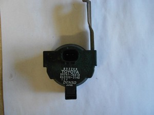

If you don't have it, adding it will be tough. Need to swap out the Body ECU AND the Back-door ECU and that is big $$$, even used. Another way to tell is look for the chirper thingy on the passenger fender wall in the corner close to the firewall. No chirper, no keyless.(You would also have to add that.)
Looks like this:

I think *MOST* 99+ 3rd gens have the hardware on the trucks. It was hit and miss in 96-98 trucks, and they didn't all have the same style IIRC. But 99+, almost all of them had it from the factory. It's easy to spot that module shown above.
Wow thanks for all the help guys! I got a chance to try the programming sequence and it worked, and for good measure, I checked in the fender well for the chirper and it has that too! So I definitely have the hardware for it, now I just need the FOB. I just ordered this one from Amazon (link), it's only $16 and if it doesn't work I can take advantage of Amazon's amazing return policy. I'll report back here once I get it and see if it will program to the car or not.
