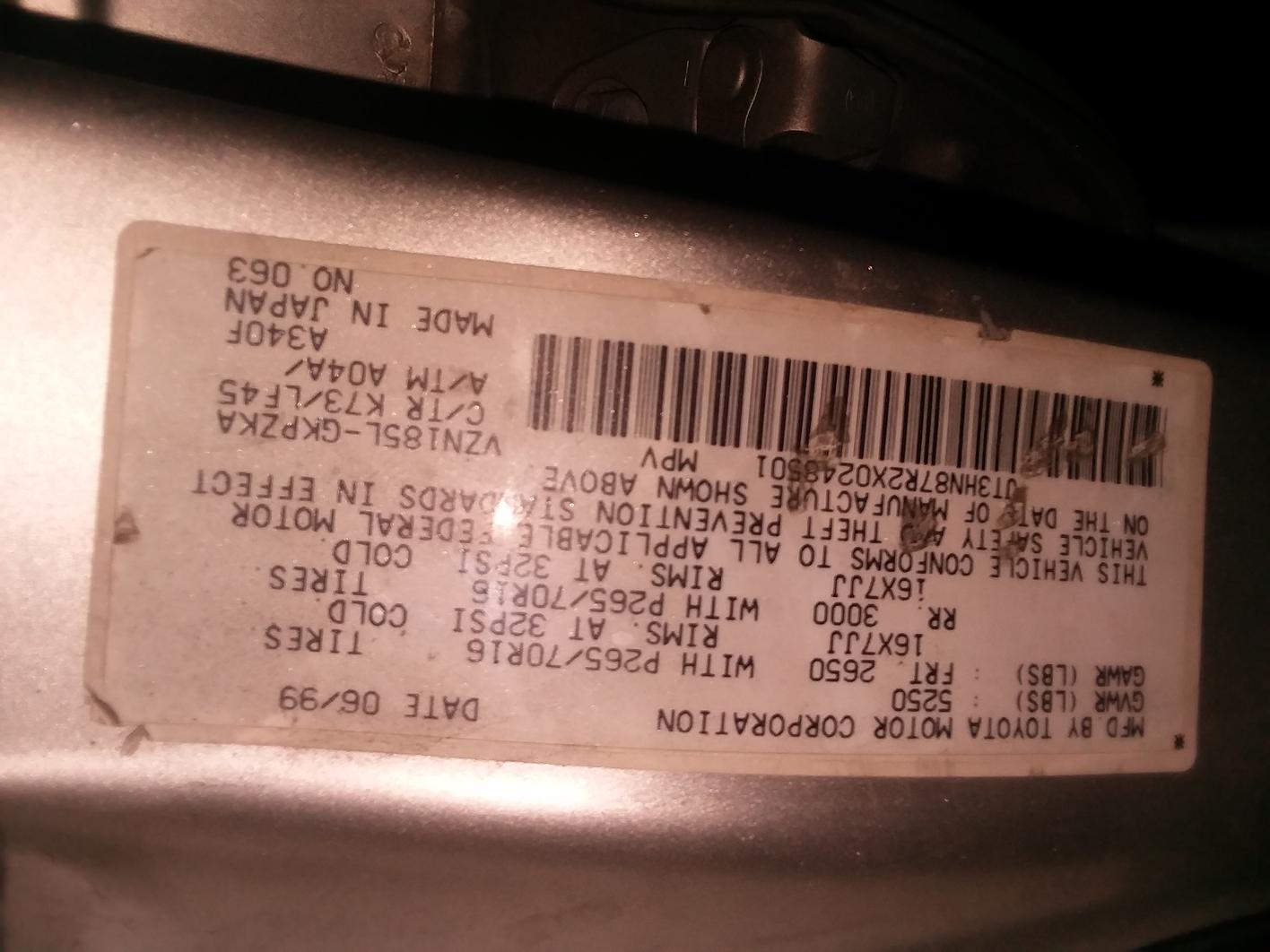

What is your axle code on the door frame? It should read A03A or close to that. Does it have a locker? Did you do a spin test to check the gearing? It sounds like some one tossed in a used one from somewhere, but things did not match up almost like it was not from a 4runner
It does have a rear locker. And I haven't done a spin test yet. Here I actually took a pic of this earlier.

A04A is normally 4.3 gearing and a locker. Do a spin test on the rear end and see what you actually have in there. Its better to know what you actually have in there before you go forward with any regearing. You should also check the front gearing too though its less likely that has been changed

Like others have said, 4.10 is standard for ones without lockers, 4.30 is standard for locked Runners. If you plan on going back with stock tires, I would just stick with those gearings, as anything else will really screw with your mpg (or maybe that's not an issue for you).
It may of had a locker, but that does not mean it does now. Should be plain as day if it has a locker or not. I was not aware Toyota put a locked diff, or a clutch style locker only E Lockers in the 4 Runner. Could have but I thought all were the E Lockers on Gen 3's.

Gearing also comes in a 3.9 which is A020 It sounds to me like some one tried to keep the locker but put in a different rear diff. Check the gearing on the front diff. I will bet that the gearing is 4.3 on the front, which would also explain why your 4wd is working at different speeds with the front and rear. This can all be corrected with the proper rear diff.
