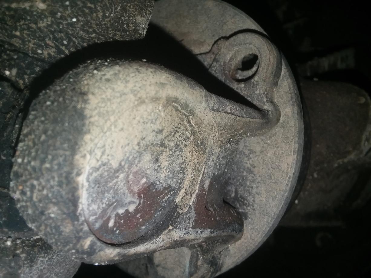

My name is Jon, I just purchased a 99 limited 4wd with 168k miles.

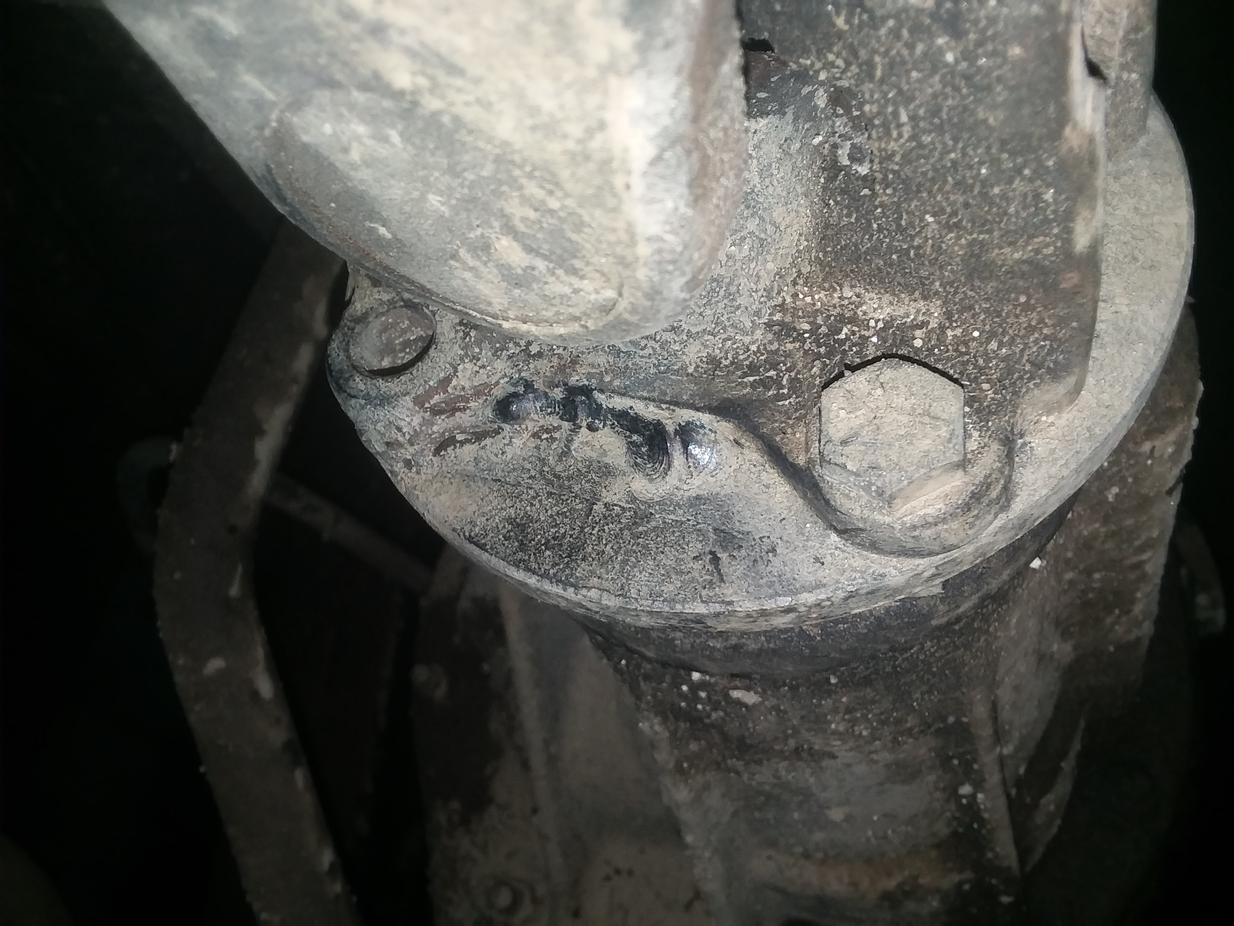

Mechanically it is in great shape. There is a little shake in the steering wheel and I thought it was just bad mounts. But upon further inspection I found out the holes didn't match up to the rear end so one of the previous owners just welded them together.
This is my first 4wd vehicle my other two cars were a 92 Volvo wagon and a Saturn ion.
Basically I want to figure out if I can just replace the flange yoke or if I need to go to the extent of replacing or rebuilding the shaft
I can't belive how ridiculous this is, has anyone seen someone do this before? I mean they aren't even decent welds, this is just completely dumb haha.
Thanks for reading!

I didn't notice a bad wobble until I got past 70.
When I test drove it I was on a bumpy freeway and I got to 60 so I couldn't even tell.
The weld on the other side is fatter and there is also two out of four bolts in it. [MENTION=116387]Unner[/MENTION]
You can replace just the flange yoke if you can get it off the flange and if you can find one to buy. I think OEM will be you're only option for a replacement yoke. I know there are aftermarket yokes, but you'll probably only find them for 1310 series u-joints.

Could not say exactly...but they must have found some slip joint that fit the splines and cobbled it together. If they did crap like that (used car lot, jimmys back yard garage) they would not have taken the time to take the diff side off. only guess I have. Just don't get in a hurry grinding and try to cut the weld. Most of the time you grind into the good stuff....burn a wheel and grind top down...usually separates well before the base metal...Diff yoke...in your situation. Please keep everyone posted up...so we know what you did and how it worked out.
I would unbolt it and see if you can break the weld they don't looked all that well done in the first place then just clean it up and put in some new bolts and go from there. BFH and a cold chisel might help as well

Yes, grinder with a small wheel and new bolts (OEM: high tensile) will solve all the issue you are having.

Aren't the holes in a rectangle shape, not square? This can't really be a case of someone trying to bolt it up 90 degrees off and instead of figuring it out, they 'fixed' it the hard way, can it?
Oy.
Correct me if I'm wrong but isn't that where the pinion attaches to? Maybe they tried to re-gear the tail end and then couldn't find the right plate to mount it to. Or just tried to mix and match pinion with ring gear with mounting plate? Any serial numbers that look funky or don't match? That is super weird...

Going to start out with what [MENTION=81049]Harleydoc[/MENTION] and [MENTION=85046]nissanh[/MENTION] said.
Unbolt and try to get it off then if that doesnt work a small grinder and OEM High Tensile bolts.
[MENTION=154475]hyken[/MENTION] I do believe they re geared the rear. When I put it in 4 the back wheels spin faster then the front so I think they actually re geared it lower.

Going to start out with what [MENTION=85046]nissanh[/MENTION] said.
Small grinder and OEM High Tensile bolts.

What is your axle code on the door frame? It should read A03A or close to that. Does it have a locker? Did you do a spin test to check the gearing? It sounds like some one tossed in a used one from somewhere, but things did not match up almost like it was not from a 4runner
