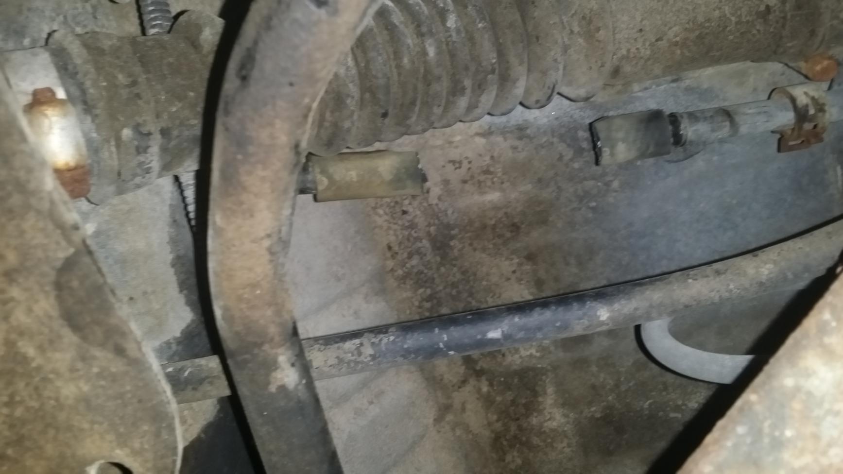

I bought my 96 4Runner (3.4, 2x2, Auto) a few months back from out of town. It's been a roller coaster of issues since I started driving it, but it's finally up to parr now driving smoothly.
Well, before I left the city where I bought it from I filled up and the pump stopped on it's own with no spill.. I filled up once in my city a few days later and no spill. Well the 3rd time i filled up the pump didn't stop and the gas was literally spilling out from UNDERNEATH the car flowing down to the street. Also, as the vehicle is off/on you can smell the gas odor standing on the driver/passenger side of the car. It's quite annoying wanting to put my windows down and the smell of gas sweeps right in.
I did crawl under to check out what may be the deal but i have no clue. I ended up making a mistake a few weeks back connecting some hose that was hanging out of the tank (above the tank) to a line in front of it, which then I found out was an exit vent hose for the tank i believe because the inside if the car starting filling up with gas fumes pretty bad and the car would start stalling and then just die. So i ended up cutting that hose off since it grabbed on pretty tight to the other line and the issue went away.
From Gas Engine Light indication i fill up with $25 (13.5gl)-$30 (16.2gl) just so that I don't make a mess at the pump with gas all over the place.. Plus, for whoever wants to throw in their .02, I've been averaging anywhere from 180-200 miles on a "FULL-TANK" well technically semi-full tanks since I cut it short every-time to prevent spill. Is this pretty normal for you 4runner owners??

The gas smell was even before I connected the hose to the line.. Cutting the hose I originally connected brought the vehicle back to it's original state. I screwed up when I connected it but the smell is not in the car anymore.. just outside of the vehicle. Below are some pic of that area..

Attached above is the photo that shows 2 lines about 4-6 inches apart from each other that are right above the filler neck hose. As you can see, both lines have about 1-2 inches of rubber hose around them. Idiotically, I connected the hose from left to right which then I cut the rubber hose in-between those 2 lines due to pushing the gas fumes inside the car. Is this where the gas may be spilling out of??

im a bit confused as to whats going on here...
but, that pic looks to be the vent line. if that is cut/disconnected, and you fill the tank FULL, it will absolutely leak from there...
When i first inspected it before messing with it, the left line had a rubber hose hanging down.. it was no connected to the line in front of it. Well, I connected it shortly after seeing that it was just hanging (figuring, ohh well maybe this should be connected here). I lifted the hose up and connected it to the line across from it.
That's when I started experiencing gas fumes within the car and the car would stutter at acceleration and then die completely. It would turn on right away, but every time I would stop and accelerate it would die. I crawled under neath and cut the rubber hose and the fumes and issues stopped.
I had the same issue you had when I bought my 99. Top off=spilling all over the ground. Smell of gas every time you stopped an parked. Turned out when the mechanic looked at it the return line was not connected. Just a simple fix for me.
Im still a newbie with these 4Runners but is the return line connected to the fuel pump?? When filling up, the gas spills onto the rear differential, not sure if that's where yours was spilling.
sorry for the late response. Mine was spilling down the front of the gas tank. The fluid definitely went forward off the tank.
