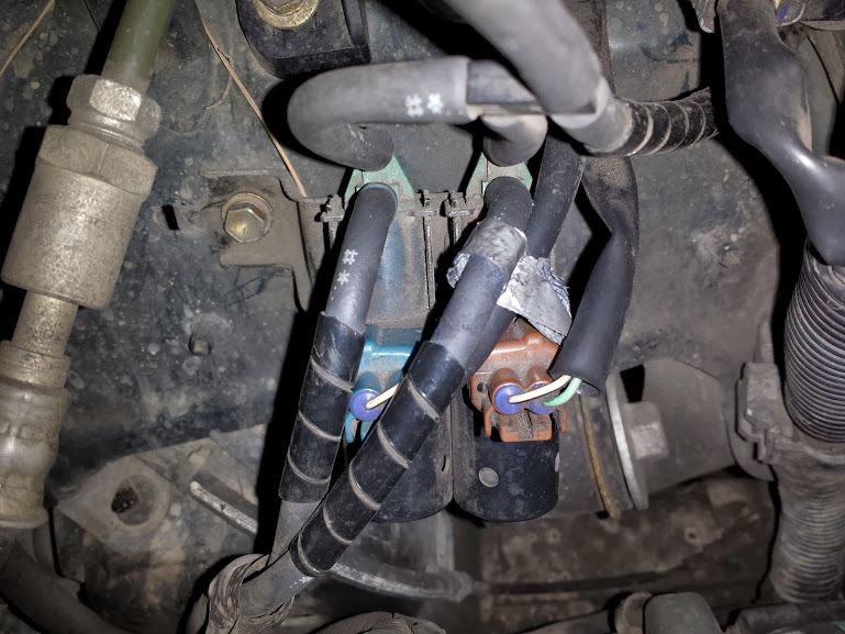

TheDurk Elite Member Mar 29, 2014 #42 seanxgodfrey said: Saw this post on another thread.. Any pictures of the vacums? Click to expand... Here you go (finally found a good one, now part of my standard post): Attachments 20140130_151036.jpg 115.4 KB · Views: 3,803 Last edited: Mar 29, 2014
seanxgodfrey New member Mar 29, 2014 #43 TheDurk said: Here you go: Click to expand... Swapped hoses and it went into 4wd and my breaks stopped acting up, going to try the rest now
seanxgodfrey New member Mar 30, 2014 #44 TheDurk said: Here you go: Click to expand... Alright, wasn't exactly sure how to use the test light , but with them swapped it works fine and it goes into 4wd.. The vacum also seemed to switch over..
