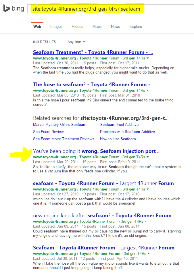

Did you read the sticky? Or do a search? I know seafoam will pull up some links.
[MENTION=65101]BrianSD_42[/MENTION] I bought the truck used a few weeks ago so I just want to do as much as I can to get it to the best shape possible. I did quite a few searches and decided to ask y'all on here in hopes of finding a more extensive explanation.
