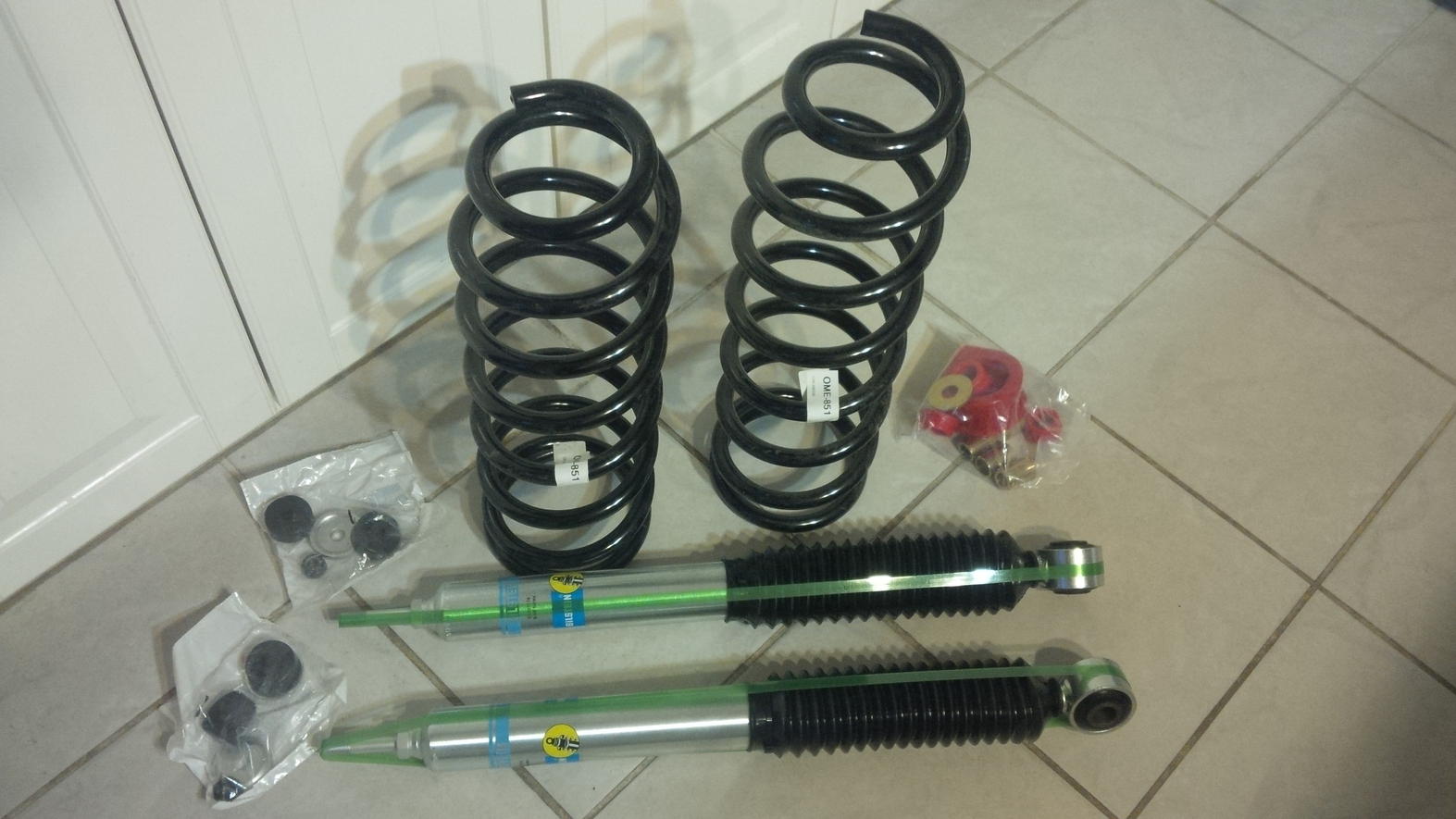

If you are planning to get with the longer bumps stop with LC's coil and avoiding the eye to stud adapter then get the Bilstein 5100 shocks. Don't forget to get extended brake line if you don't have it yet...I got this LC OME 851 with Bilstein 5100 to be install this weekend. Getting rid of 891 due to sagging rear with OME weak shocks. I broke two sets in 4 years.
