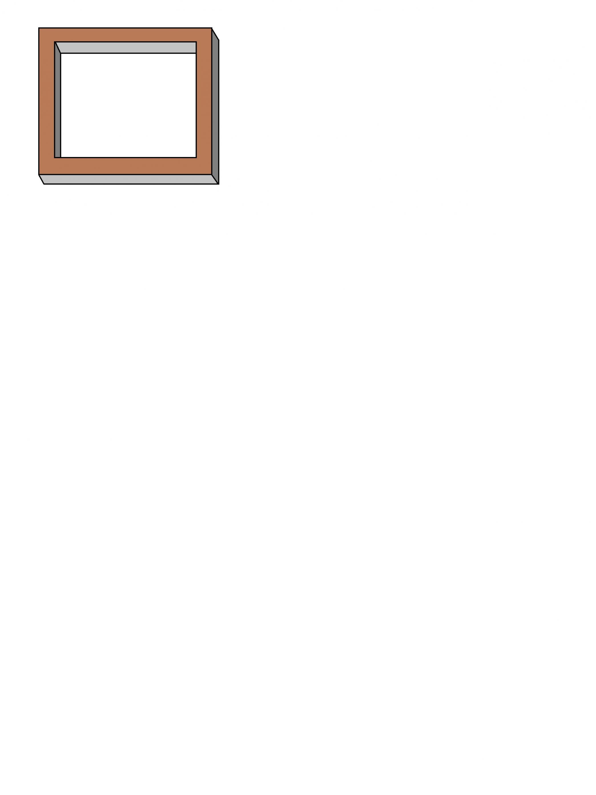

Ok so I recently replaced my 3rd row with a drawer system that I made. It’s been working fine for off-roading and daily driving but had a pretty big issue when I had a bunch of stuff loaded on it a couple weeks ago for a camping trip. The dang thing wouldn’t open…. The weight that was sitting on the top board was all resting on the drawer faceplate and It was nearly impossible to open. I thought the aluminum angle a attached to the front of the top board would offer some rigidity and prevent this but I was proved wrong.
Any suggestions? There is nothing supporting the middle of the top board as it’s 1 large drawer. I’m thinking I should have done two drawers so there would be a support in the middle but I’m a little past that… and would rather not redesign everything and buy more parts. What do you think…
What about a frame the size of the top, all the way to the edges, made of 2x4s, with plywood screwed to the top of the frame, like another shelf almost? You could even leave out the 2x4 that sits over the aluminum front, and just use three 2x4s and the plywood. The weight of what's on top would then rest on the three sides of your drawer unit, not on the front. And the frame could just rest on what you already have, no need to screw them together. So you could just lift it off and leave it at home most of the time. Plywood not depicted in this crude pic, but imagine not being able to see the frame due to the plywood.

Aluminum angle is not very strong, I would try replacing it with steel angle iron and paint it.
I build custom cabinets for a living, other than a stronger angle I don't know how to solve your issue, hopefully the steel angle will work.
That would definitely work but I little more than I want to do. I don’t want multiple pieces to move around.
I broke mine into 2 separate drawers with a middle piece providing additional support.
I’m thinking steel angle next ooorrr a C channel over the edge. Instead of just the angle. Gotta see what I can find that fits nicely.
Another thought is to cut down the drawer face a bit to give more clearance when it sags from weight, even with the steel angle it's still go to sag some when there's weight on the top.

If it was me I would just cut back the edge of the top piece and make a new faceplate that is slightly taller so it still has a clean look.
Also, throw a big handle on there. It helps opening a heavy drawer!
