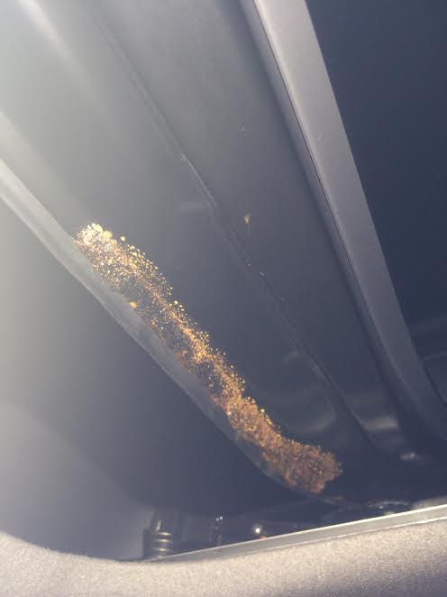

I just bought my 08, used obviously, and I bought it out of town(about 400miles away) so I do not want to have to take it back over something that may be simple to resolve. Has anyone found any definitive resolution to this issue? It's my fault for not checking out the sunroof before I bought it, but I was pre-occupied checking for other things on a 6 year old vehicle with 80k miles before i bought it. Attached are some pics of what mine looks like. It rained here today, there is absolutely no water in the sunroof track. I will test the drains tomorrow but I highly doubt they are the issue as no water at all in the inside of the vehicle. The only wet area was when i touched the rusty spots in the pics. it's like water is getting in there and sitting, but not traveling anywhere else- thus creating rust along the edges. And its not very much water either, just damp. Any help is much appreciated.

I actually just found this same problem on my 4runner. It finally became nice out and now I find this ugly rust. It's mostly above the passanger side along the leading edge. Pictures to come. Also 2008 4runner sport. I wonder if there was a bad batch of something.
Possibly a bad batch of seals? I mean it seems easy enough to fix or get fixed... The question is what actually needs fixing. My seals look perfect, no cracks or unusual wear that I can see. It's not right now- but could turn into something that totally ruins the truck
I just got in the Runner tonight and found rust in the seat. My wife said she had the sunroof open earlier. I looked around and found my sunroof looks the same as the pictures on this thread. The seal looks good and the truck is always in the garage. I am upset to say the least. I wish I would have caught it sooner. I would like to know what the fix is.
I haven't had the time the past few weeks to work on a solution. I am thinking it has to be a sunroof seal issue. I think i am going to try removing the rust, sanding it down and painting it, then putting a bead of silicone on both the outside and inside of the rubber seal. If nothing else, it will take a very long time for rust to build up like this again. If years from now its happening again, maybe I'll replace the seal/sunroof/ whatever...
Same issue on my 08 sr5. I saw this thread a few months back and checked my sunroof and it was fine. I checked today and it looks like the rest of the pictures on here. I wonder what caused this (water obviously) and how to help others prevent it. Where the sunroof seal meets he car there are dirty drip marks leading me to think that the main outer seal on the glass is to blame. I will clean it tomorrow and try to come up with a fix. On a side note, I replaced the rear window seal when I bought it 9 months ago because it was falling off when I would roll the window up or down.

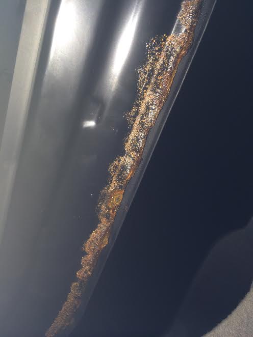

I had this issue a few years back now on my '05. You can pop the sunroof glass out, sand the rust off (assuming it isn't too bad) and paint it up. One may be able to re-use the seal if it's not deteriorated and re-seal it with silicone. Mine was rusted pretty bad (which surprised me since the rest of the truck is really clean) but I never use the sunroof so I had forgotten about it!

I pulled the sunroof and the seal. Before I did I noticed that the seal wasn't touching the painted car side like it should be which allows water and dirt in. But the seal does not allow for the water to get to where the rust is. This makes me think that it's the humidity that is causing the rust. The rust starts at the top of the metal rim under the seal.
So I pulled the seal off the metal and cleaned the rust as best as I could. I let some phosphoric acid soak in for about an hour and touched it up with black POR 15. I made sure to paint the rim really well as I think this is where the rust starts. When you pull the seal out there is a fair amount of sealant that comes out with it so I bought a new tube of it for replacing the seal. It got a bit messy but it took about 5 hours including paint dry time. I still need to figure out how to fill the gap between the seal and the vehicle side. I'm thinking some type of thick rubber tape.

I am currently speaking with a VP at Toyota to address the premature rust that has accumulated on the sunroof of my 2008 Toyota 4runner. I have been seeking a fix for over a year now, and the rust is only getting worse. I know I've seen others post on here, as have I about this issue, but I would like to consolidate the threads and posts to show Toyota that this isn't an isolated issue, and deserves attention. I would greatly appreciate any members to take pictures and post them w/ your year and model, of any rust on the frame of your sunroof, as I plan to present this to Toyota. I will keep everyone updated on the progress and the outcome.

some pics of my issue:
