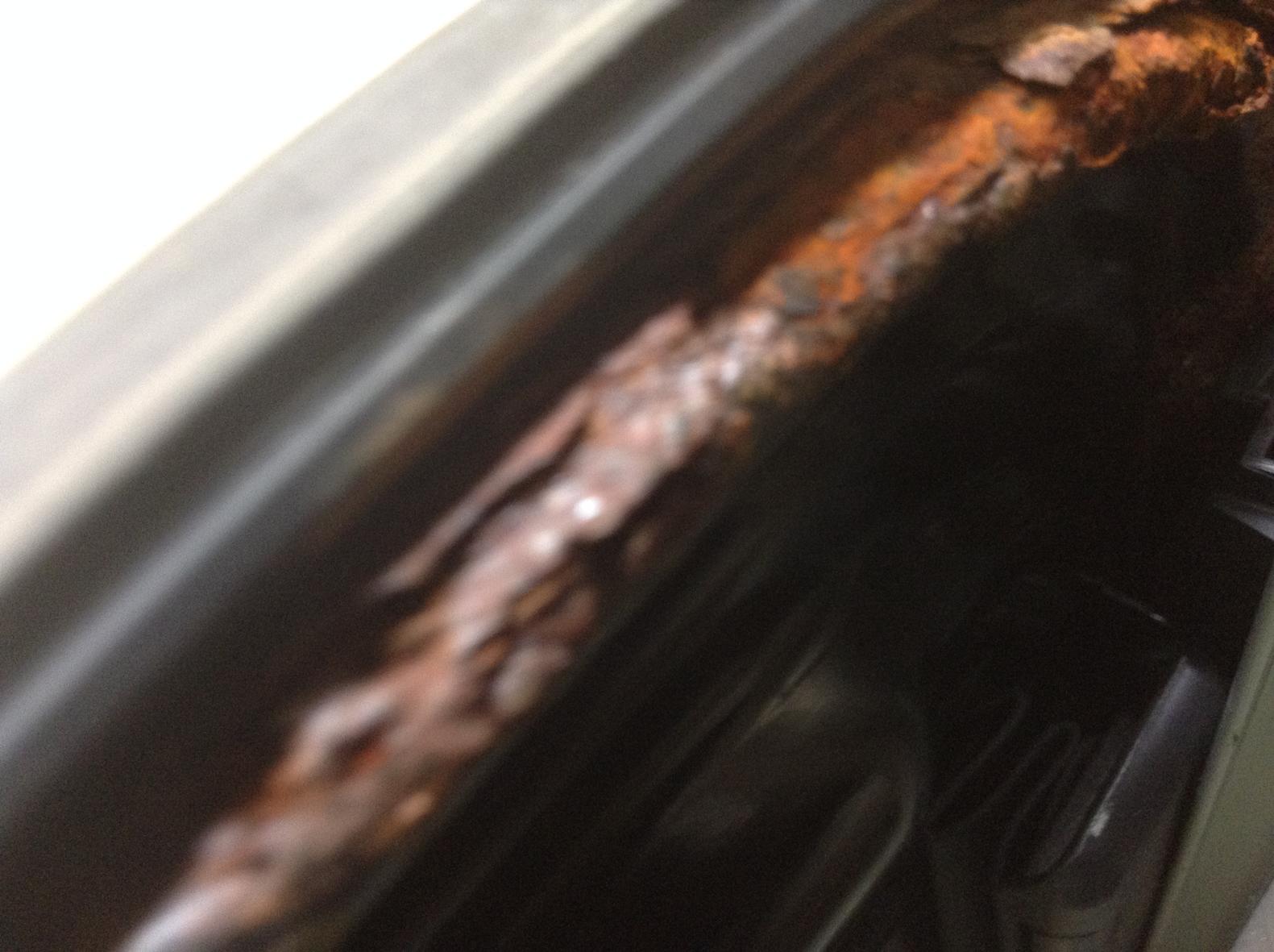

My 2007 4 runner sun roof is rusting dealer wants $1200 to fix. I check my 2009 Corolla and found rust dealer wants &1000 to fix.Toyota seem to have a problem with rust on the sun roof.I call Toyota and they say if they have more complain there may have a recall to fix that problem

Just bought my 4Runner and it has this same rust issue. Does anybody have any resolution? I'm taking it to Toyota today for an inspection and to get thier thoughts on the sunroof. I'm sure they'll say 2000$, replace it.
1) I wouldn't drop 2k to replace without knowing why it happened in the first place
2) I won't drop 2000$....
I've looked at buying the assembly and replacing my rusted one then, fixing (sanding bondo painting) and reselling but again why did it happen to begin with?
Is there a way to remove the rusted frame with glass so I can take that one part to the body shop to get worked on?
Thanks in advance

There's a glass assembly on eBay for 950 shipped.
2007 Toyota 4Runner Limited Sunroof Assembly Glass Actuator Motor | eBay
So I'm assuming if you visit the local junk yards you could find one for cheaper as you won't need all the parts.
You can remove just the rusted part, but you will have to take the headliner out, then its just a bunch of bolts. I might be wrong here, but I would take it out sand it down, and then paint it with POR15 and replace the seals if you could.

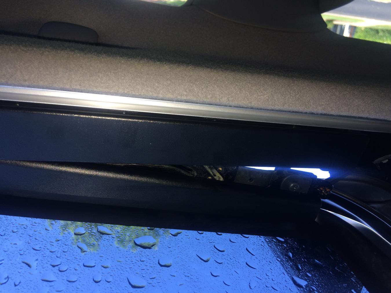

After some more research I think the offending part can be removed without headliner removal. Another link in this thread gives a play by play but I'm stuck at step one
I see the scew on the back side when the sunroof is vented but the cover on the sides seems difficult to remove. Any help?
I Attached a picture I hope

Bumping an old thread, has anyone with this problem found a solution or what is causing this besides sittingg water? .. i've owned a few cars with sunroof and not once have i noticed anything like this.. My 06 also has this issue but looking thru the diagram i can't pinpoint what parts needed to replace the contaminated items.. do i have to order a new sunroof or can the pieces be individually replaced.. i believe the seal around the glass may need replacing aswell..

From what most have said here on the forum in several threads is you have to replace the entire unit, either new or used, they can't find just parts, pieces or gaskets new.

From just examining mine it feels as if the seal around the glass really soft.. so the question is if i were to order a new glass roof will it come with the parts thats rusting away.. been looking at the parts/diagrams for the past few days but havent been able to pinpoint what it is..
You have to replace the glass assembly to fix this problem. You can't buy the seal separately. It takes less than 10 minutes to remove the 4 garnish pieces, 4 T25 bolts and lift it out. The only thing you are removing is the glass assembly.
