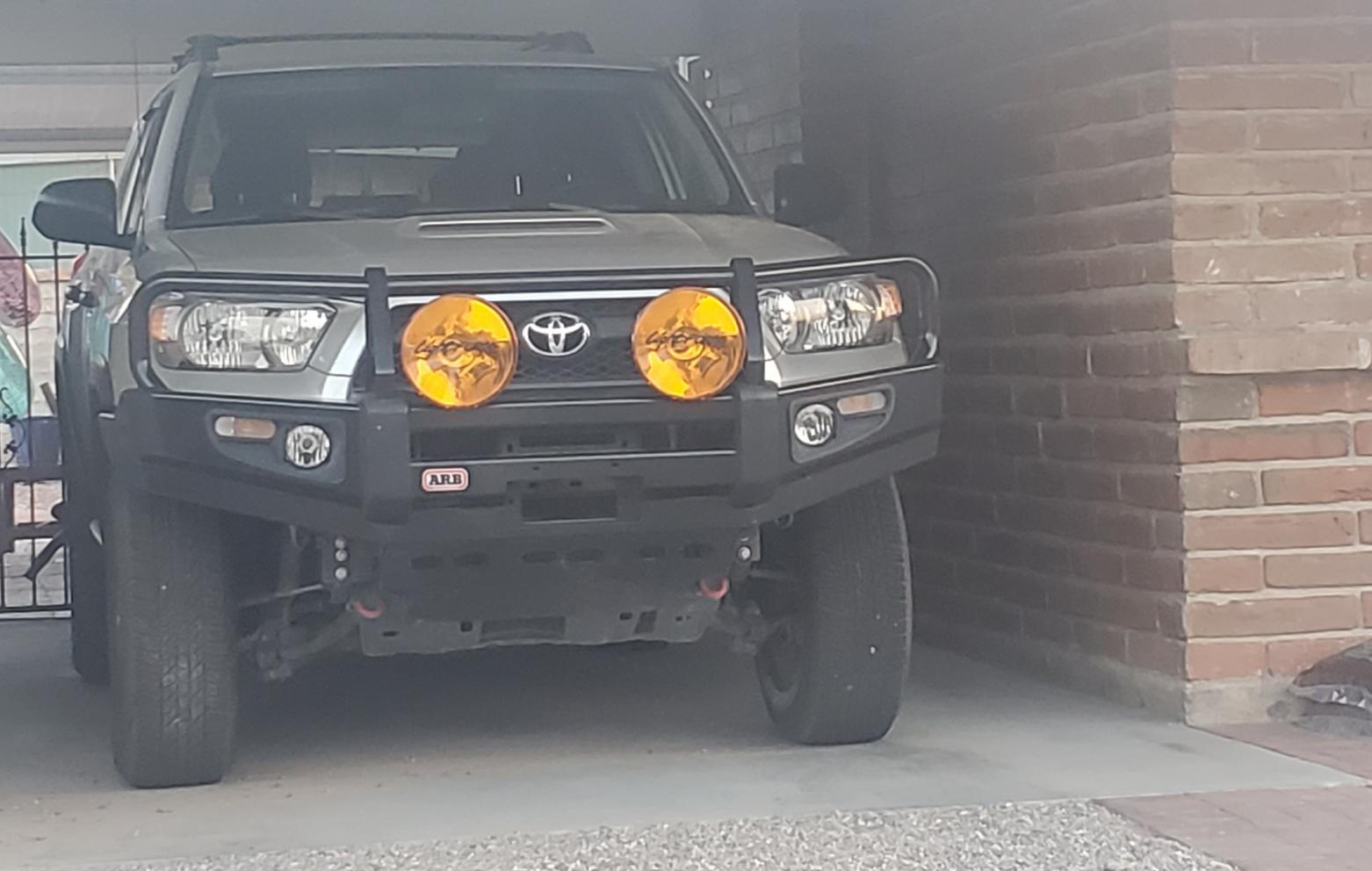

I love my ARB. It is very heavy, and you'll notice the weight under acceleration and braking. Youll definitely need an aftermarket suspension setup to handle the weight, I went with Dobinsons.
As long as you adjust your driving habits accordingly and get a good feel for it, you could be fine. I drive a little slower and brake a little sooner, a little more distance between myself and others, I pay attention more but none of those are bad things. I've had the ARB for almost 3 years and driving with it is like second nature now.
I took a fuel economy hit, a few mpg's I think.
I added lights of course, since it's just begging for them once you install it. And it deserves them.
No winch here. Not yet. I mostly bought it for protection from animal strikes. There are a lot of deer and open ranges here in AZ, elk wandering around in northern AZ etc.
I daily my 4runner and have taken it on several 2000+ mile road trips and I do not regret the bumper in any way. It's a seriously well made bumper. I wouldn't go back, and I would do it again without hesitation.
