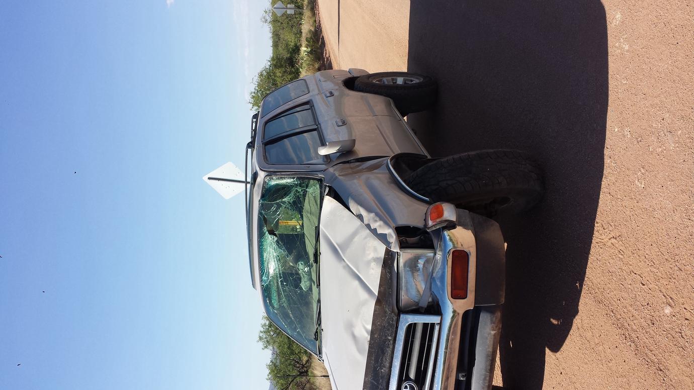

Abs killed my truck
On dirt road at 25-30mph the brakes went abs and I could barely slow down(15-20 percent power). In60 yards I slowed maybe 5-6mph, in part due to quick downshift. She rolled, is dead. But I'm completely uninjuried. This is the short version. Great for pavement, not good for dirt. Learning how to post, but I've been around awhile. I think these pictures will come up

The aftermarket brakes weren't your problem. The ABS just sucks on these things... The ABS is so simple, I doubt different brakes would make a huge difference in this case. On more modern stability control systems, definitely the brakes could make a huge difference (negative difference in ESC), but the 3rd gen algorithm is so simple I think that the brakes weren't the reason you crashed.
