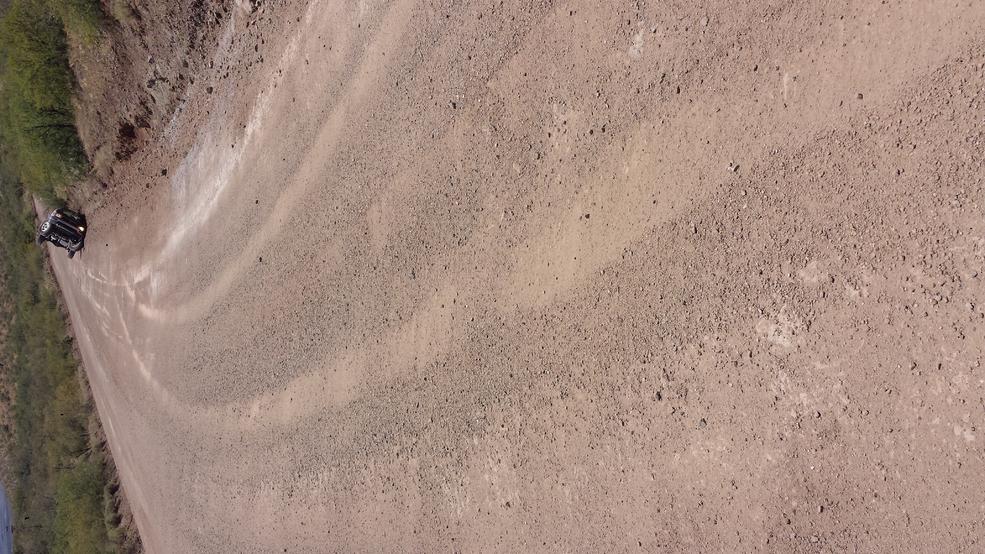

This was May 31st. I had control, abs kicked in as soon as I applied brakes. Check the chatter marks. Chuckles your help posting is awesome, thanks
On my next runner I'm going to install a switch to turn off abs. Does anyone know if Toyota proper gives a flying hello about 18+ year old vehicles? At least my children wern't with me, I'm unhurt and I have a whole gen3 5spd for parts on my next rig. Anyone is az, need parts let me know. I still love these trucks.
