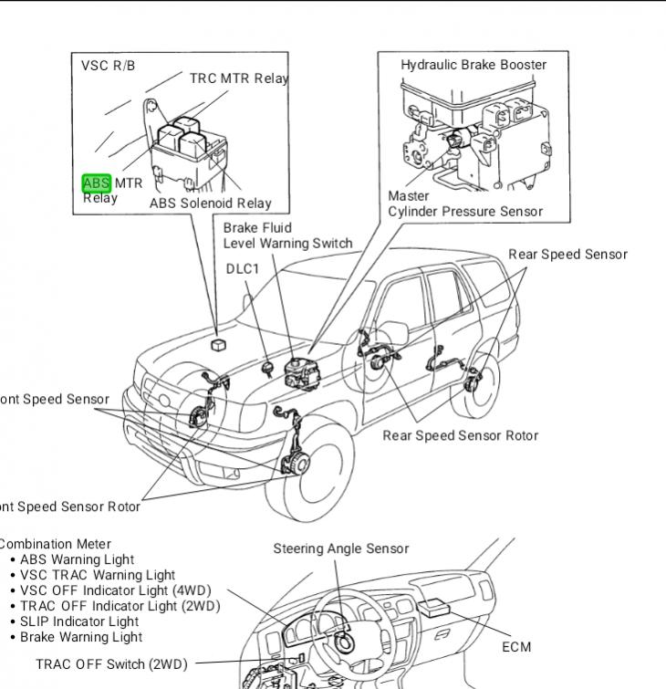

Those c0278-c0279 are caused by the abs relay or circuit. The abs relay is located on the passenger fender in the engine bay.
Yeah so the relays as far as I can tell are working. I can here them clicking on and off again as the computer keeps trying again and again to read power from whatever abs system isnt recieving it. Fuses connected to it are fine as well. I think the key thing here is that the fluid is rising all the way to the top of the system. To the point where the pedal cant be pressed at all because its back pressured, and simultaniously theres no pressure on the brakes because theres no fluid in the calipers, its all moved to the top of the resevoir. Its almost like the booster is working backwards
