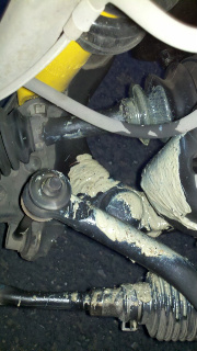

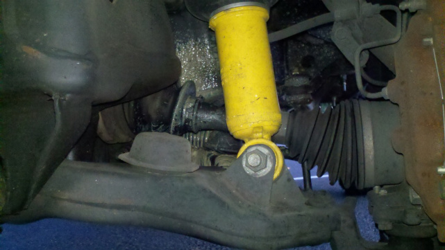

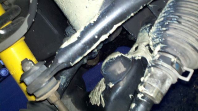

What did I break?

looks to me like your cv boot ripped and threw the grease everywhere, and it also had water in it.... best i can figure...
u can continue to drive it, but you will lose that cv joint... not that big of a deal beacuse its the front and you dont need it for street driving... however, if you use 4wd you will need to replace it asap... might get away with just a boot and a repack of the grease.. but once grit gets in there it will die fast.

how much do u use 4wd? if seldome.. i would do the boot... just clean it real well.... if alot, i would go the half shaft route... try a search and see f there is a dyi here.
That boot doesn't look ripped from what I can see of it.....that goo looks more like oil and water.
The OP should maybe check the radiator for goo and his oil for more goo.
Isn't cv grease usually dark green/blackish?
agreed.. however the grease in the cv will turn that color w water same as oil and water will.... and its right in the cv area........ but check these things too. :fishing:

na im 100% sure thats just a torn boot ..also call around here in albany too if no luck down there

That definitely looks like a torn cv boot. Anyway sorry to go off topic, but I noticed that you have an OME lift..do you have the diff drop also? Again sorry to go off topic but just really curious..
