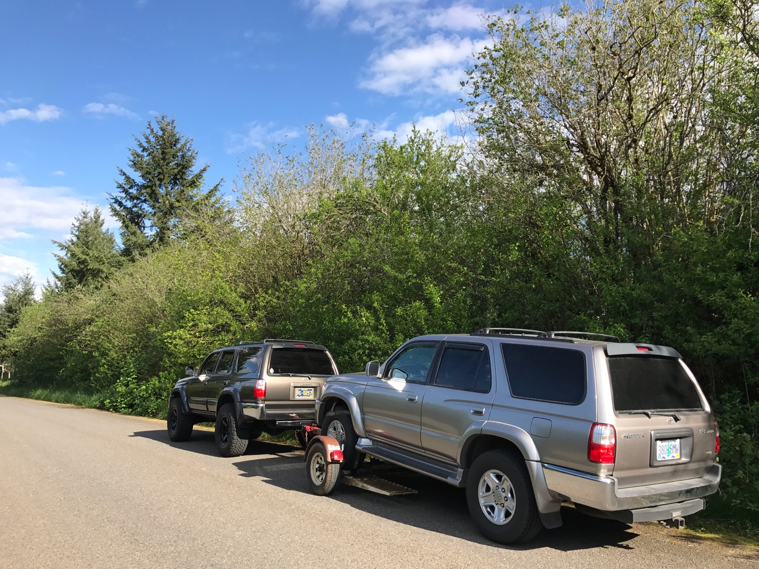

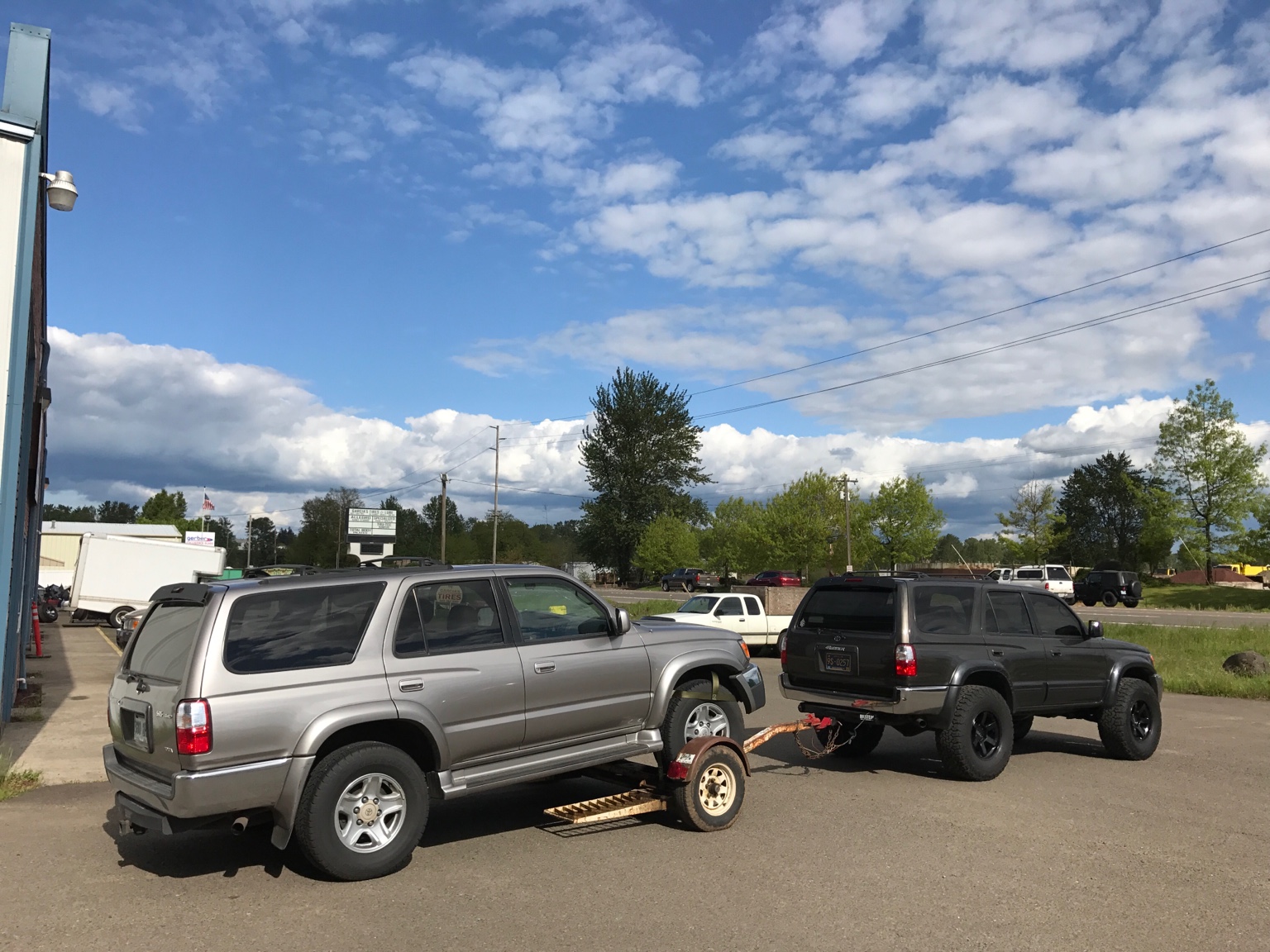

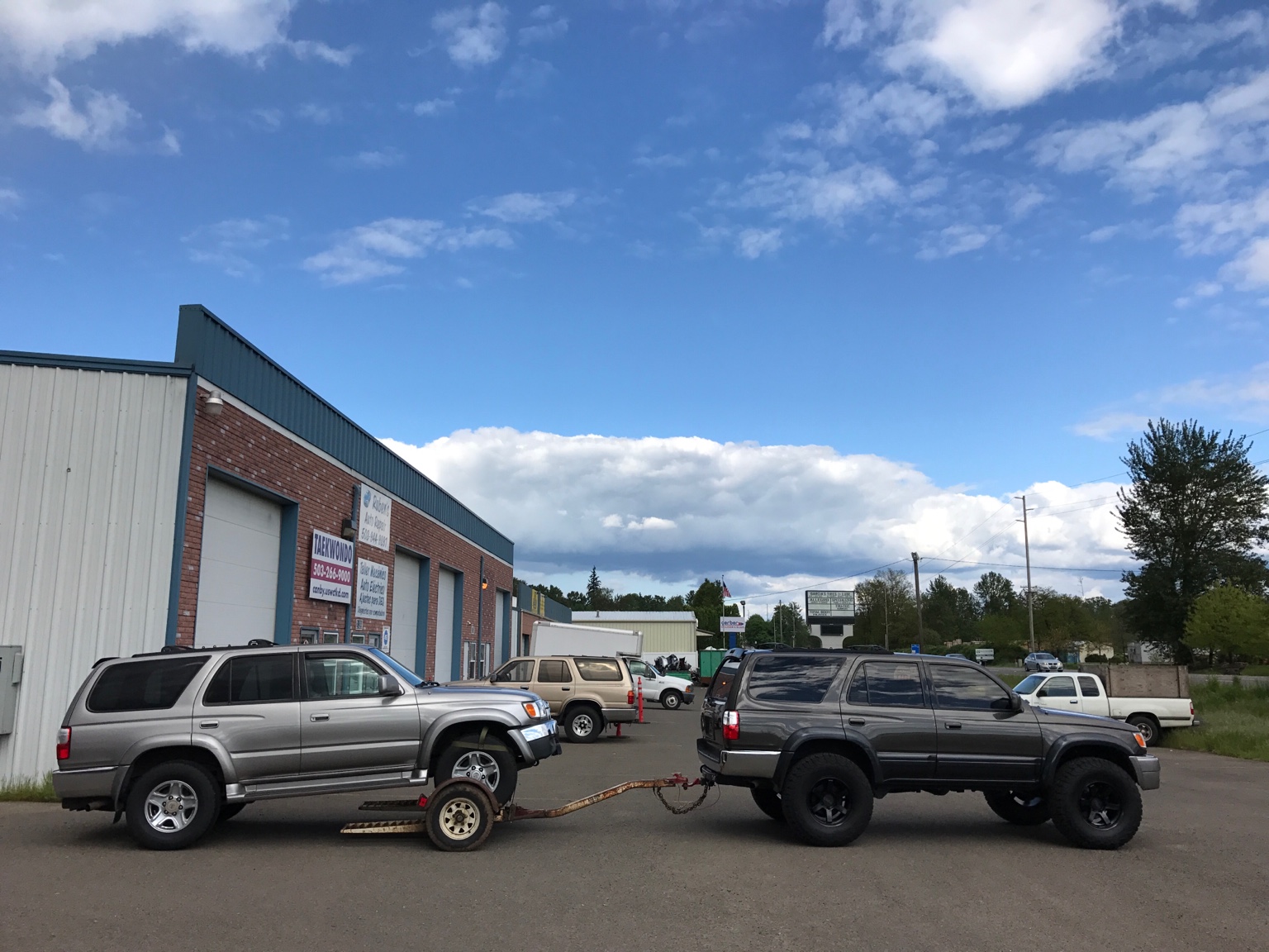

I grabbed a dolly, and went to pick it up. It was parked at a trans shop, and the 4R owner said "you can start it. It starts right up and runs great". So I started it, and it did run great. I was like "what the hell? Let's see what happens", so I put it in D. It was as if I was in a manual, and just let the clutch out- with the brakes on; it tried to move forward and died. We pushed it onto the dolly, and we were on our way.

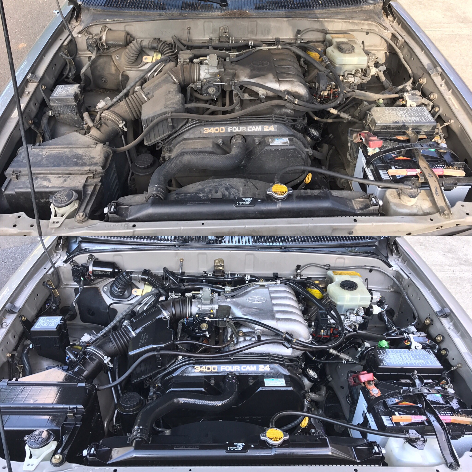

After cleaning up the engine(PFA)-

What did you use on the engine bay to get it so clean?

What [MENTION=148927]Toyotayoda[/MENTION] was referring to is you shouldn't tow a vehicle with an automatic transmission by the front wheels with the rear wheels on the ground. The driveshaft is turning the transmission but the transmission isn't being properly lubricated because the vehicle isn't running and powering the transmission fluid pump which is moving the fluid throughout the trans and to the trans cooler and back. Basically, you cook the transmission. Not good. If you drove though only residential streets and a short distance, you probably didn't do damage. If you actually got on the highway and drove a long distance, you probably did damage towing it in this fashion.
I'm guessing you might not have read your owners manual all the way through. In the towing section it gives a NOTICE "Never tow a vehicle with an automatic transmission from the front with the rear wheels on the ground, as this may cause serious damage to the transmission."
