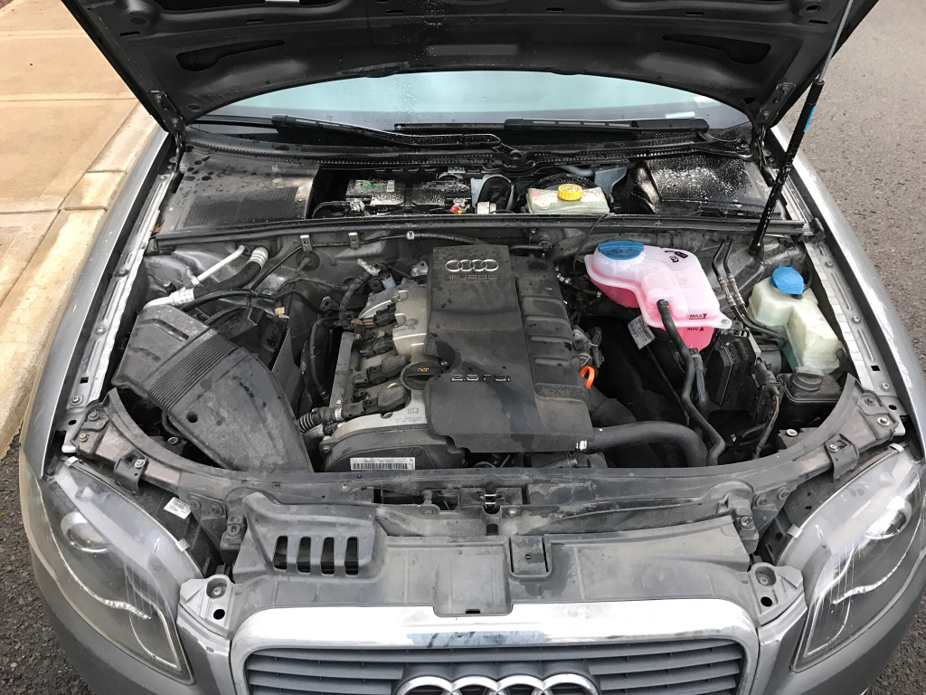

OP still hasn't said what he used to get his engine bay to look that good...now I'm curious!

That product looks like what you put on After you clean it...but looks nice...would also like to know the steps he took to make it look so nice....:hatsoff:
Thanks!
I just sprayed the heck outta it with Simple Green, pressure washed it at point blank with a hot pressure washer, and finished with Stoner Trim Shine.
I do all the engine bays I clean this way-
