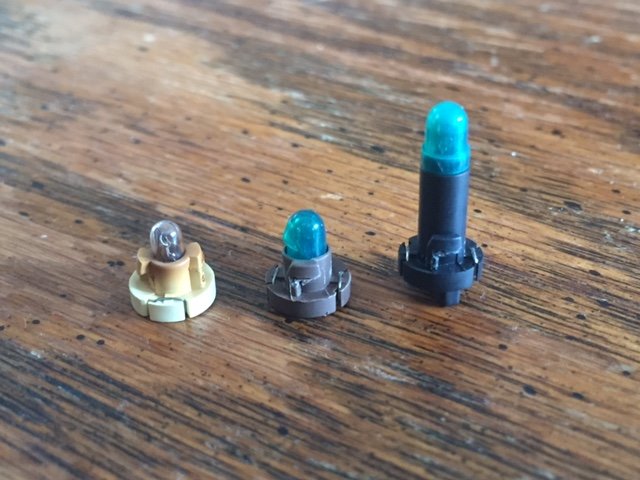

I now have my whole dash apart on my 2000 SR5 4Runner. I have replaced all the instrument lights with blue LEDs except for the ones shown in the pic. I have looked at the super LED lights website and can't figure out which ones I need. In reading the (very informative post) it says a Neo-wedge type A and B but I'm not sure I've picked the ones that will fit. Also, can these bulbs be removed from the housing?
They are as follows, L to R. A/C control button, ECT button, and then the Rear Window button. If someone can find the ones I need on Superbrightleds.com website and post the link to them I will order them later today. Until then I'm not going to put it all back together. Thanks ahead of time for any help. This old brain if mine is just not what it used to.

All the same. 3mm T1. Don't worry about the LED not being the "tall" type as the LEDs are plenty bright to light up the buttons it lights up.
https://www.superbrightleds.com/mor...ulb-high-power-instrument-panel-led/221/1004/
