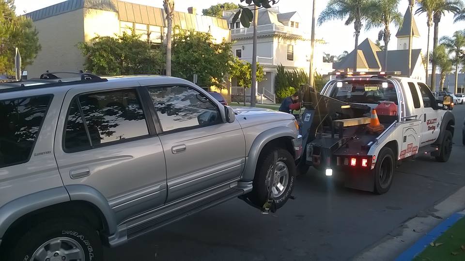

Hi All - I have a 1997 3.4L V8 Limited 4wd 4Runner with approx 144k on the mileometer (Im British OK!).
It was driving fine since I bought it two years ago with no problems other than the Engine seemed to run a little hot but the temp gauge never went above the middle and I live in SoCal so I thought this was probably normal. I had to top up the Coolant a few times as it seems to eat through this every few months.
This week my wife drove to the shops as normal but when she tried to leave the Engine wouldnt turn over at all and there was a loud one time Click/Popping Sound. This happened two or Three times and then she called me - I said to try it again so I could hear but this time it turned over and started fine so I hung up.
She then called back a few minutes later and said that the car had been shaking and White Smoke Started bellowing out of the exhaust pipe. I told her to wait there and I drove over. When I arrived I checked the oil etc and found the Coolant reservoir to be empty so I topped it up with water (all I had). I started it up it would still turn over but was a bit shaky and after idling for a few minutes the white smoke started coming from the exhaust pipe along with dripping a lot of what smelt like water. There also appeared to be water dripping from under the bonnet (Hood) somewhere near the passenger foot-well.
I got it towed to a local garage that I trust (But who is not a Toyota expert) and he said that he thinks that the Engine overheated with water getting into the pistons and it is unsalvageable so Im going to need a new engine!! Does this make sense? Is there any other possible causes that I can suggest as I dont think I can afford a new Engine...
I love this Truck as its my first ever car and we have been all over together in the last two years since I moved to the US: Yosemite, Mt Whitney, San Fran, LA, Anza Borrego, Vegas, SLC, Bryce Canyon, Zion Canyon, Grand Canyon, Mexico - I will Honestly cry if we have to Scrap the Beast...
Thanks in advance for your help
