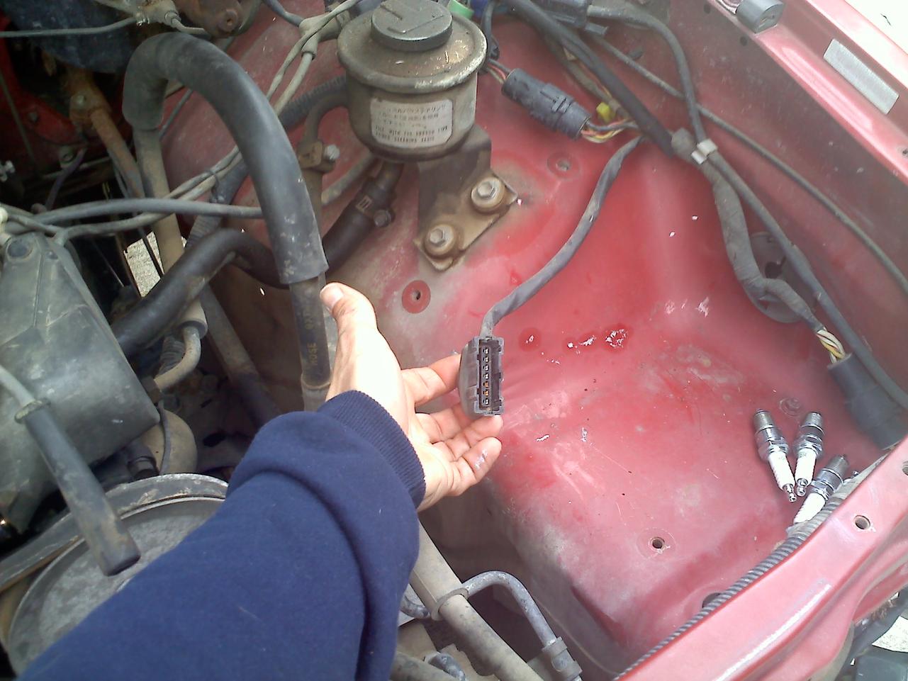

Just picked up a wrecked 88 4Runner. Gonna use the drivetrain in a Suzuki Samurai if I can get it running. My question is this - there appears to be a component missing from the engine compartment - just behind the driver's headlight. (See pic) What is supposed to go here?

Yeah - I just found it in the FSM... Is that the same as a Mass Air Flow Sensor? That's all that comes up on Autozone.com when I search for "Air Flow"

Yes, that would be the same part. I may not be 100% correct but it should not run without it feeding its information back to the ECU. There is a green plug near your igniter (can barely see it in the picture) that you can jumper that forces your fuel pump to run regardless of the AFM signal. You could give it a shot and see if it will fire up.
