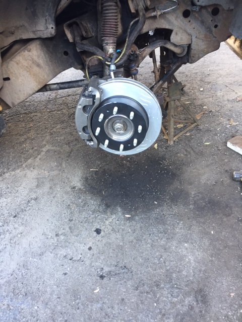

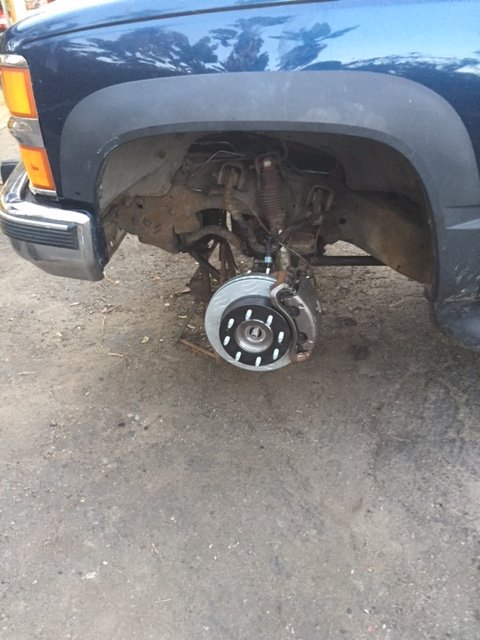

My 6.5 has a much larger turbo for towing, upgraded high flow water pump, upgraded exhaust from turbo back and a tune flashed on the ECM. It is producing around 270 hp and 485 ft/lbs torque vs the stock 195/385. You definitely feel it. Aside from torque and hp, it’s the drivetrain (trans), rear axle gear ratio, suspensions and brakes that determine how much you can tow.
Front brakes have been upgraded to the dual piston calipers of the next era GMT-800 trucks. The pads are much bigger and the stopping power is substantially better. Some guy made a YouTube video on this conversion, largely from reading my thread on another forum.
Truck was rated to tow 8,300 lbs, but easily handles 12,000 lbs.
