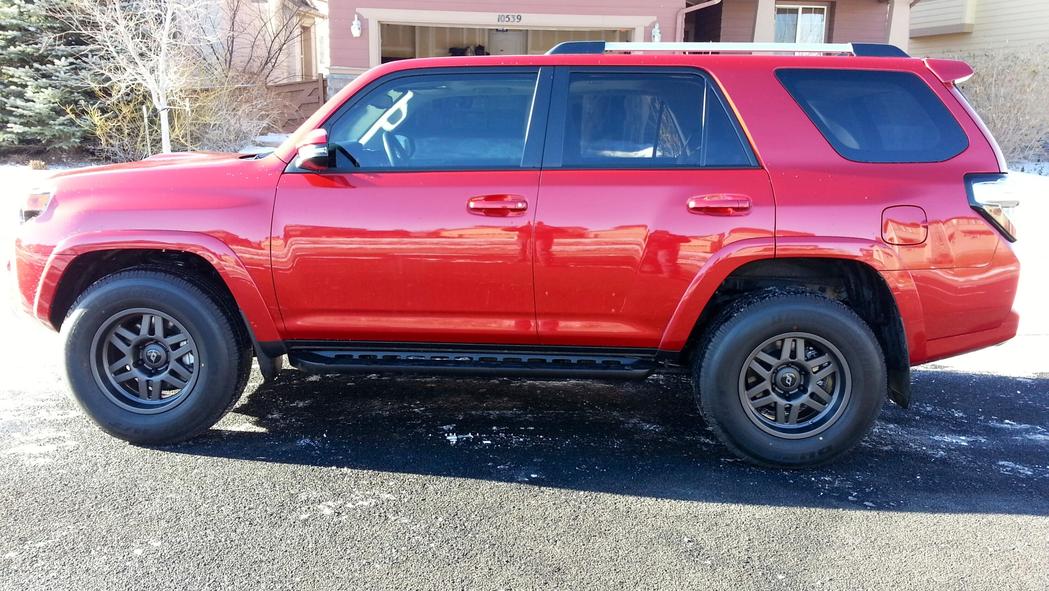

I have a 2014 Trail KDSS. I'm running SCS Stealth 6 wheels and yes, they are beautiful. Lol. I'll b adding a Toytec 3" lift BOSS system. The great guys at Red Line Landcruisers down in Colorado Springs will perform the lift install (Great guys).
Considering my wheel size (17x8.5). Which size of Duratracs Ican be safely install without rubbing? I won't cut or do any sort of lining mod. If I touch it, I'll brake it. I'm a gorilla. Plz keep in mind I've been using the search button.

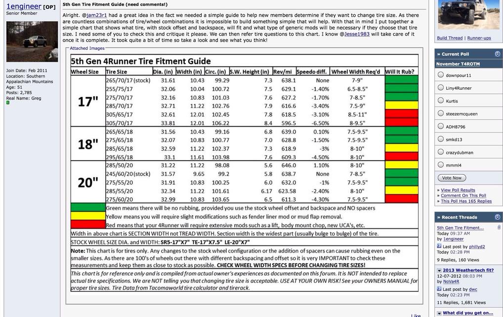

*I believe the size chart below was made for stock wheel sizes*
If you want to run DuraTracs without rubbing on a 17" wheel regardless of width you need to keep stock size (265/70/17). They only come in stock size and 285/70/17. If you go with 285s they will rub without any fender mod.

Truck looks good BTW
If I thought or had heard of ANY wheel that you could run 285 tires and not rub I would have colored it green with a note. Some wheels are better than others but I built the chart on an optimal BS and offset regardless of wheel width.
You'll regret not getting 285's with a 3" lift. Almost every person that had 265's ends up saying they wish they would have gotten 285's. Just do the UCAs and fender mod and you'll be fine.
