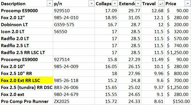

Front fox 2.5 dsc, spring rate can be changed too 700 no problem.
Rear, all these people talking about a shock with a spec'd max lift of 1.5" will ride fine higher, sure it might but you won't have much down travel. Get too long of a shock collapsed length and you won't have enough up travel (anything much longer than 17" is too much for stock shock mounts with 3" bumpstop stop). If you're wanting to do longer or long travel here's some rear shock measurements that should help, that 11.5" travel measurement seems to be the sweet spot.
I have fox 2.5 dsc fronts and used to have 2-3" lift fox 2.0 remote res single adjusters rear "Ext RR LSC", I now run fox 2.0 universal stem top 10" non resi for slightly more travel, lower price, and less complication. If I were to go all out with 2.5 rears I would have to look elsewhere than fox, they just don't make one off the shelf. King has the best measurements for a 2.5 long travel remote resi rear.

I have a friend who REALLY wanted Fox shocks because of DSC, and as mentioned above, was offered the Tundra shocks to get close to the travel he was looking for, but ultimately still didn’t provide the kind of travel he was looking for. He said Accutune was fairly helpful, and they specialize in Fox. But he’s going King’s as well.
The problem I ran into is tracking down a 2.5 shock with 11.5ish travel. ICON and King both have options, but Fox does not. Accutune spent more time than I expected helping me figure out a potential solution, including contacting Fox directly. Unfortunately, Fox could't - or wouldn't - build a shock with similar specs to the ICON or King shocks. The best option Fox has is a SuperDuty shock (Accutune can tweek it for our application) with 5.5" of uptravel and 10" of total travel, although it only gives you about .5" of more travel than the Tundra shock.
