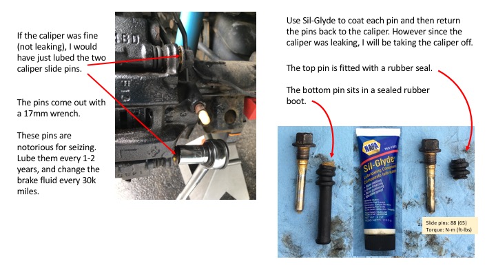

Are you referring to the two "pins" below? If so I have two you can have.
It totally IS! Thanks so much for the offer. However I think it'll probably just be cheaper to get them locally rather than shipping. There are still some pretty big challenges:

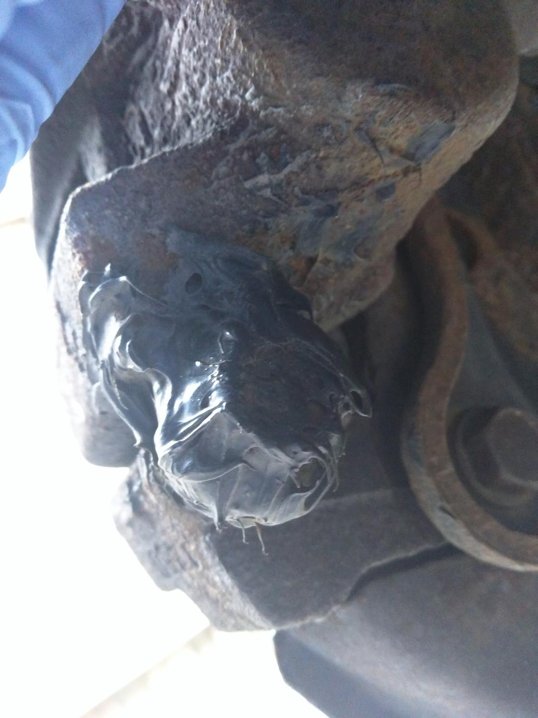

I have been known to use 5 min epoxy to get a bolt to stay put when things are not ideal and time is short or the proper fix is not practical. It lets go with heat (a propane torch is plenty) and a 1/2 inch breaker bar. Acts like a great self locking nut.
However, being that it is the brakes we are talking about, I would just replace the bracket and the caliper.
Yep - picked up a new caliper. Seems way easier than trying to reuse what someone screwed up. Does this look like the epoxy you speak of that can be loosened up with a torch and breaker bar?

I wonder why someone would even put epoxy in there. what. .. lol. Makes changing calipers a nightmare.
calipers should be changed in pairs. so go ahead and get the other one also.
Crap - the other one looks to be in such good shape though. I was so excited about how easily I changed the pads... and then I saw the epoxy mess on the other one. Stopped me in my tracks
Yep - I really have no idea. And it'll certainly be more of a pain. It just doesn't make sense to me, I don't even know what it's functionally doing!
Calipers should not be replaced in pair. Pads and rotors yes. not calipers. that's just spending money to spend money.
you are wrong sir.
in fact, its the opposite of that. rotors can be replaced singly, although its a good idea to do them in pairs. but calipers really should be replaced as a set. they work together in a hydraulic system.
if he changes just one, in a couple years he will be back here asking why one side has more/less wear than the other.
Well. You think what you like. It's good to replace all kinds of things. its good to have new stuff. But hes replacing a damaged caliper. Not a frozen one. And rears are much less prone to freezing that the fronts. And just because you think one will go bad down the road is no reason to replace it prematurely. Is it BEST practice to rpeace both calipers? Sure. Is it necessary. Not at all.
By your logic (they are part of the same hydraulic system) he should replace all four calipers. And what sense does that make? We don't drive race cars for a living. We drive 4x4 grocery getters to and front work and then on the weekends we turn wrenches to get our jollies. Don't over think it.
